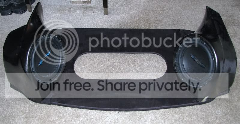

Yeah there is not really a DIY,but we can answer most any questions you might need,I finished doingmine last month,takes a long time to do,think I have 80 hours into it,and a couple of hundred dollars,working on the false floor for the amp to sit under now.......here is a picture of what I got as of tonight......about another 12 hours work
that is nice! good work man
