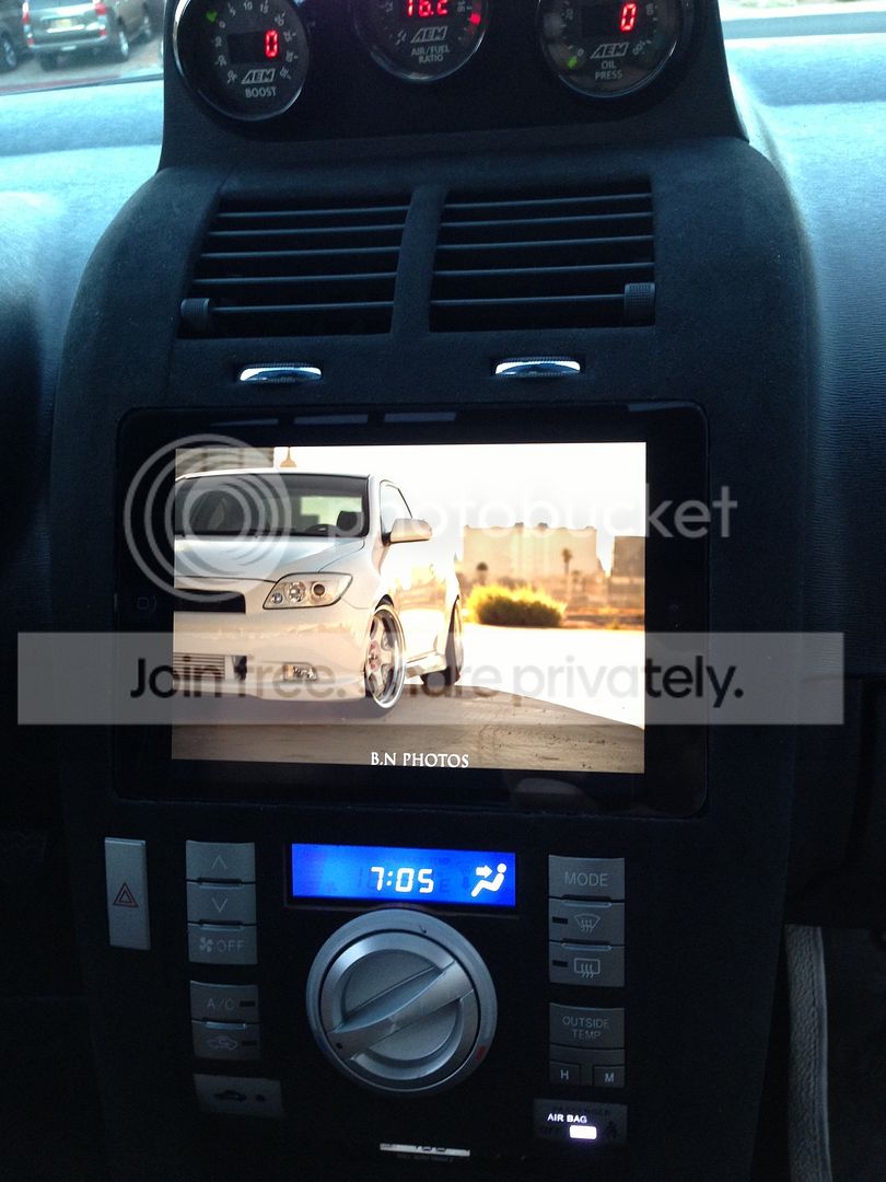

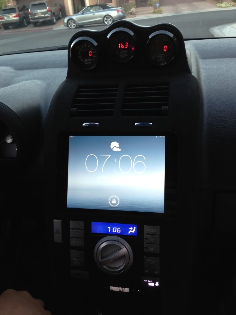

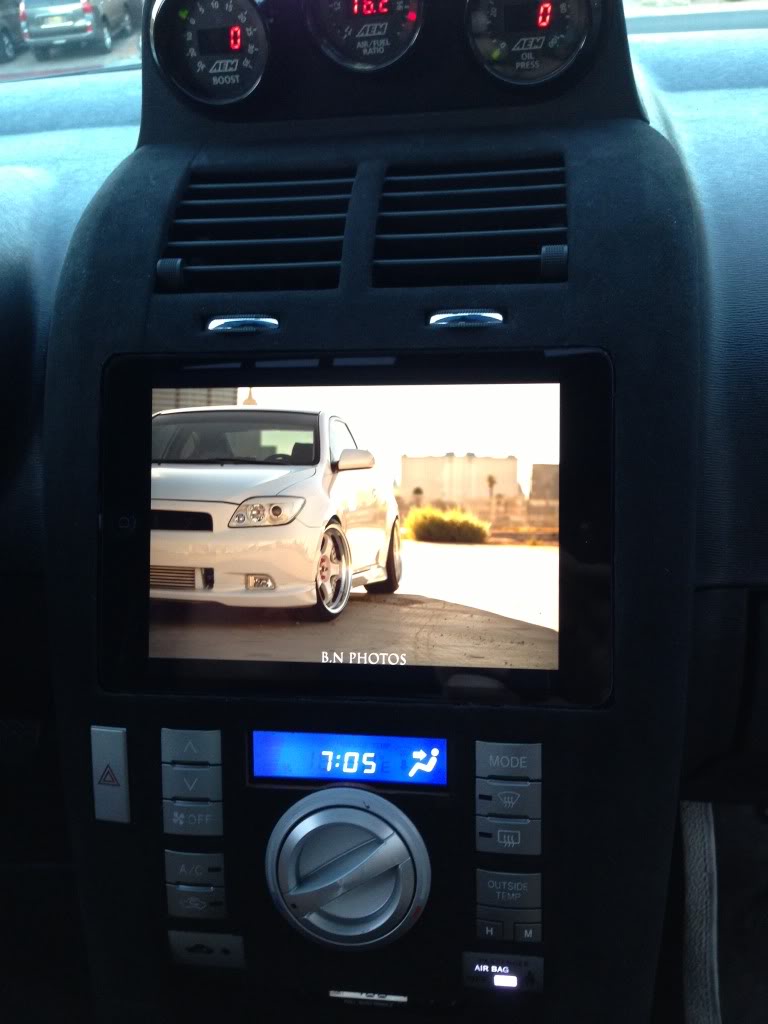

Finally installed

^ looks awesome!! now do u still have a radio hook up? an the mini just slips n over it via bluetooth connection? or do u just have the mini solely as your headunit?
Old Apr 16, 2013 | 03:45 PM
thehundreds702's Avatar
Joined: Feb 2010
Posts: 298
From: Las Vegas, NV
Ipad Mini is my head unit; runs lightning connector into the Istreamer; then from there RCA to my Bit Ten; then out 4 channel to my amplifier; and 1 channel to my sub amplifier.

Originally Posted by thehundreds702
Finally installed
Looks good man. I have done three ipads in customers cars (all mini's) none of them in a tC. A few questions, how did you mount yours? Can you pull it out pretty easy or is it fixed there?
How do you like the bit ten? I have been using the JBL Ms-8 works pretty well and its a little cheaper then the Bit Ten, but I am dieing to work with the bit ten as soon as i can get a customer to buy one.

Default Basically removed the door for the radio; laid the iPad in there..
Originally Posted by vernach14
Looks good man. I have done three iPads in customers cars (all mini's) none of them in a tC. A few questions, how did you mount yours? Can you pull it out pretty easy or is it fixed there? How do you like the bit ten? I have been using the JBL Ms-8 works pretty well and its a little cheaper then the Bit Ten, but I am dieing to work with the bit ten as soon as i can get a customer to buy one.
Basically removed the door for the radio; laid the iPad in there and it only needed about a 1/2 an inch off the top for it to slide right in; so cut that out with a Dremel Tool and a very careful hand lol. Once the iPad could fit into the opening; it actually fit kinda tight which worked in my advantage; after that flipped the entire piece over with the iPad in it; and used JB Weld plastic epoxy putty and covered the entire back; over the iPad and the sides of the radio plastic; this created a tight bond and it holds the iPad from falling back; I covered the iPad with blue tape first so I didn't get epoxy on it; after the epoxy cured I popped the iPad out and took off the tape.
Now I'm left with basically a pan for my iPad; It pops right in and is pressure fit; I've had it installed for a couple weeks now and it has not come out yet; however if it does I will probably use some sealant to attached the iPad to the epoxy for a more permanent hold. I wanted the iPad to be a fixed install to where I can't remove it. I have no need to remove it and I like that its wired to the Istreamer and all times. I use Wifi sync and send all my music to it from my laptop when my cars parked out front. Another neat thing I found is the smart cover will still lay over the iPad to act as a cover; in case your parking somewhere that you don't feel safe with an iPad as a head unit lol.
As for the Bit Ten I couldn't recommend it enough; It makes the system sound so much cleaner and the computer program is really nice for changing crossover points and setting the EQ for the system. I will be installing a bit processor in my vehicles from now on!
