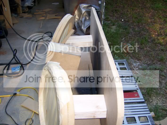

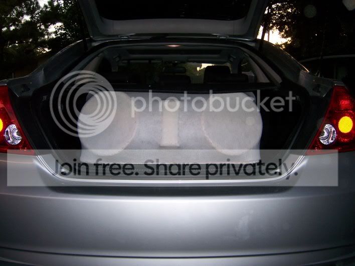

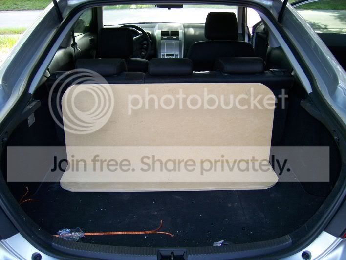

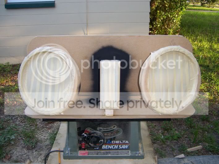

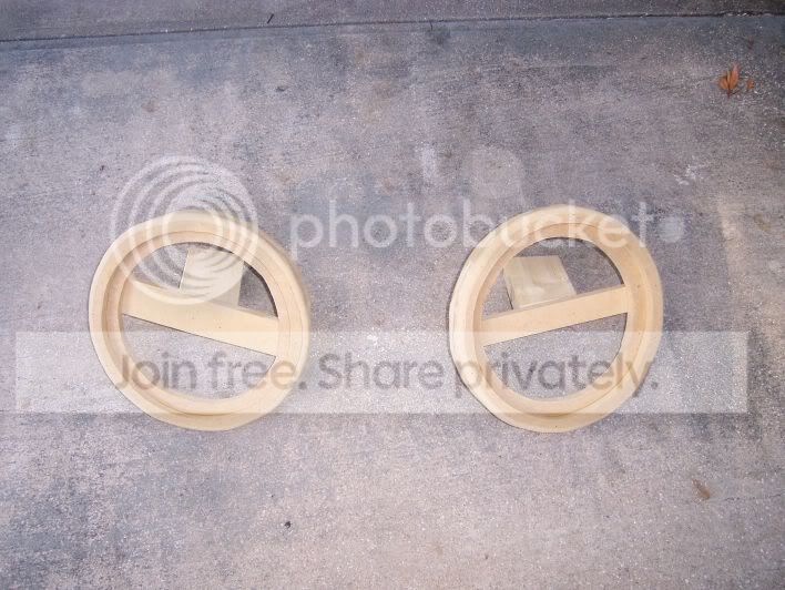

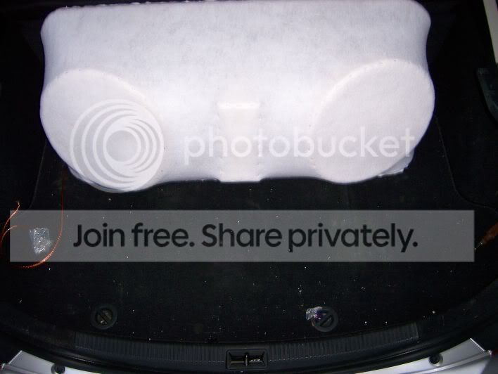

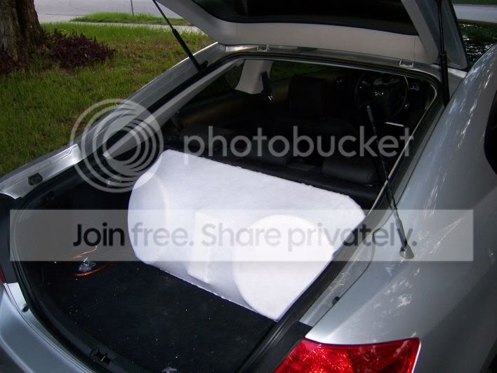

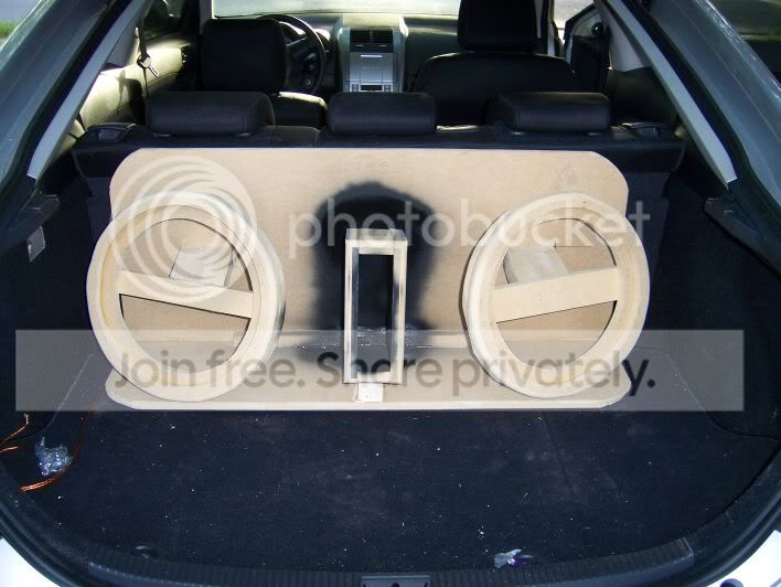

I'm really happy with the way this one is coming out!

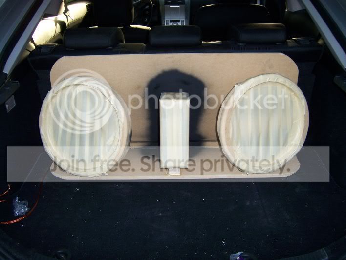

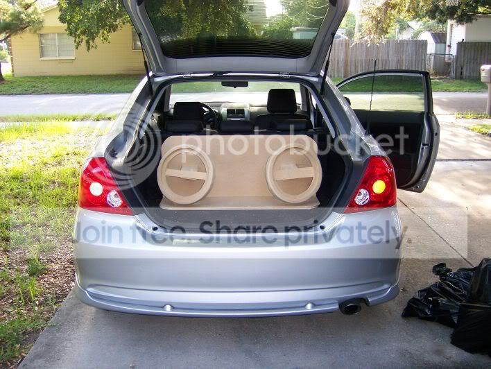

On saturday I'll put on the resin and fiberglass, I just can't deside weather to paint it or carpet it in black. This one is 2.3 cu. ft. and ported @38Hz, so I've got the right air space and still have room in my trunk. It's a Win Win
Ta Da truck space
The base is only 8 1/4" deep but the subs stick out another inch.

That looks awesome man. What kind of subs you gonna put in there?

looking good dude! no rear reclining anymore though

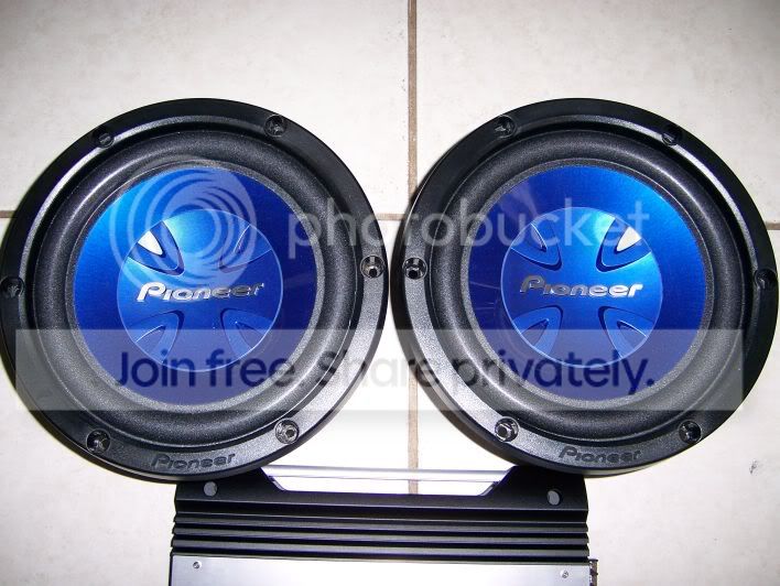

Ive got a couple of pioneer TS-W251R 10" subs
actually the back seats are in there normal position. Im even going to have enough room to mount my amp on the back of the box Ill post pics of that when I get to that point

I saw that the seats are in the fully upright and locked position. I'm talking about losing the reclining feature that allows you to make lounge chairs out of the interior. I do this all the time, so i dont want a box that loses that.

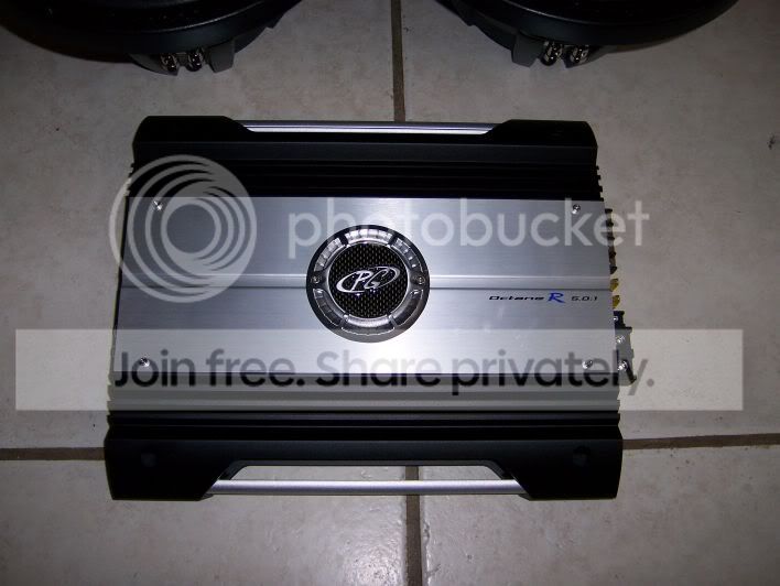

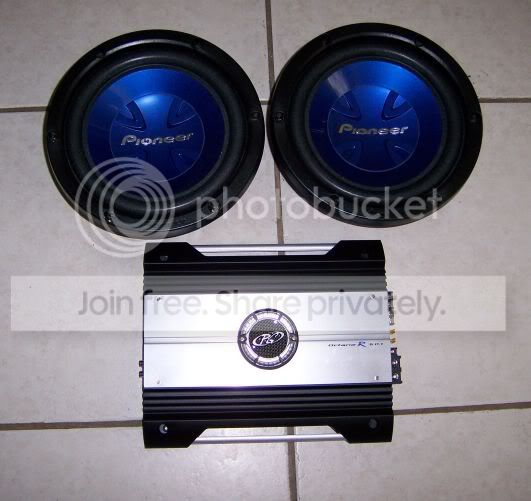

Old Aug 9, 2006 | 10:28 PM
fujitech43's Avatar
Posts: 127
From: Tampa, FL

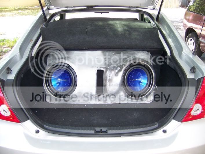

This is a pic of the subs, and my new amp i just got today

I am looking to do a similar setup in two weeks, but with two alpine type R 12s. What kinda mounting depth are you able to get out of that?

I've got about nine inches at least and I only need about 6 for these subs, but I can make it as deep as I need.

Im only charging around $280 for a box like this, plus shipping. I can make it for 8" 10" and 12" subs. Ive even come up with a cool idea today for doing three 10" subs in a box like this one, just put the port on the bottom going side to side and the third sub in the middle higher than the other two and facing more upwards. Of course that would stick out a little more but its just an idea. I got the resin done today and sat I'll start sanding. I'll post more pics as the project goes alone. My goal is to have it completed by sun evening so well see

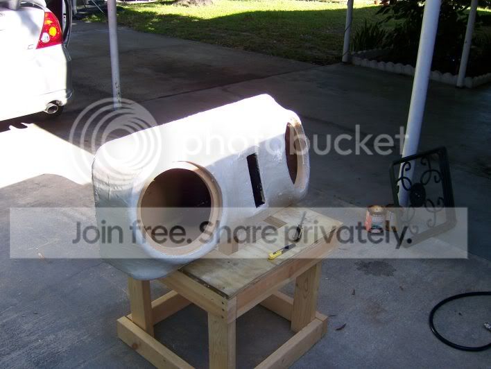

Old Aug 13, 2006 | 02:07 AM
fujitech43's Avatar
Posts: 127
From: Tampa, FL

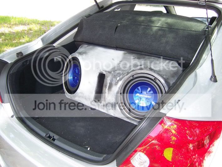

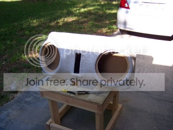

keep in mind this is not finished, I was just looking at how the colors look to see how i want to paint it. I should have it finished tomorrow
after sanding
by the way it sounds great
