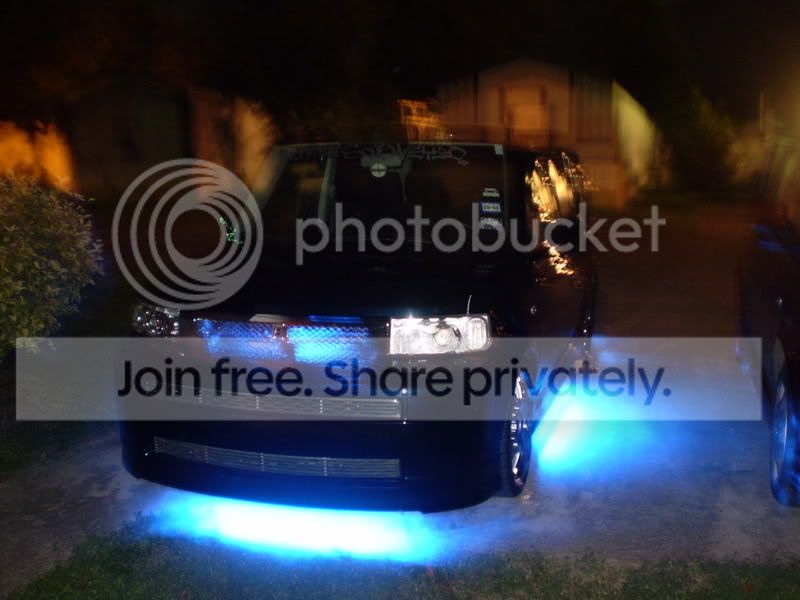

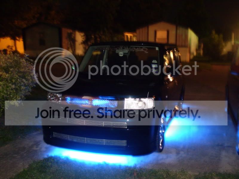

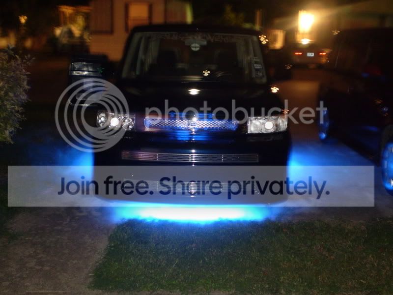

Here are the pics which are from the led help you gave me and the led underbody kit I installed. Again thanks for the help!

Hey man, looks great. Glad I could help. Keep up the good work. Later.
