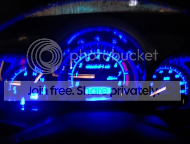

Old Mar 19, 2008 | 05:07 AM
  #127
cavalierkid888's Avatar
Posts: 965
From: Eastern Illinois University

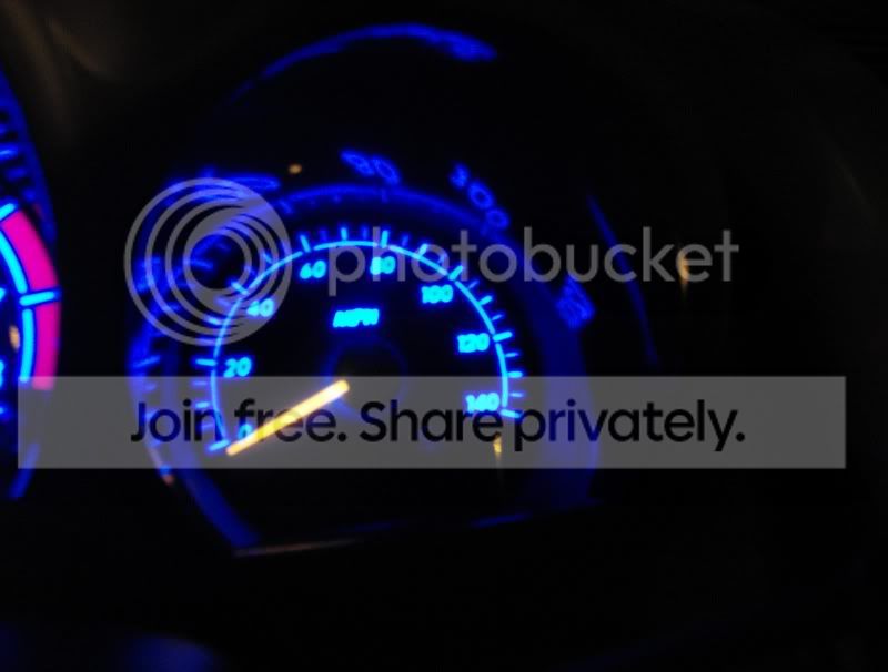

Sorry for the crappy pix.

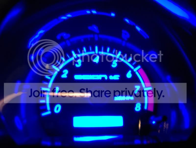

Old Apr 3, 2008 | 03:43 PM
  #128
ChrisLilja's Avatar
Posts: 218
From: Round Lake Beach, IL
Default Re: Official: show your LED GAUGE swap!
Originally Posted by tC4italy
Show them off & if you want to state who did it! ;)
EDIT: Ok....maybe I should have made it clear in the first post...I don't want to see "led sellers" products in this thread =/ there are already threads out there like that. This thread is meant for the SL people to show their OWN gauges not gauges that they have made for others. Thank you.
Mine (done by Garage) blue & sky blue:
How do you get the numbers to be white while the ring around them blue? This is what I was interested in doing....Also I heard this VOIDS your warranty? is that true, and if so which "part" of your warranty (electrical system or something) ?

Warranties cannot be voided at all. IF an electical issue with the gauges pops up after you do the swap, they most likely wont cover that incident, but the warranty is still intact.
To do white numbers on blue gauge faces, you use white leds and apply a blue film on the back of the gauge face where you want it to be blue. Most of us that do the swaps carry the fim as well.

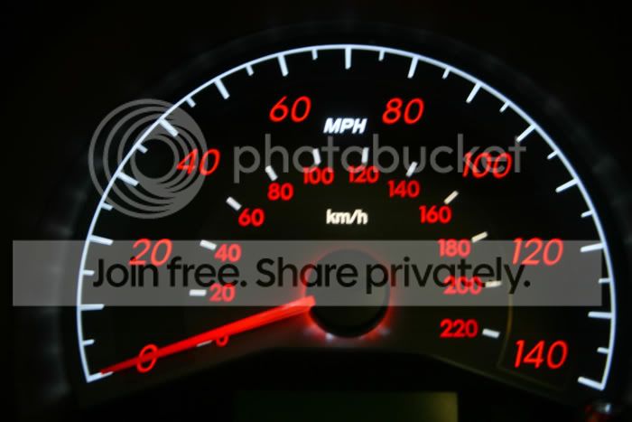

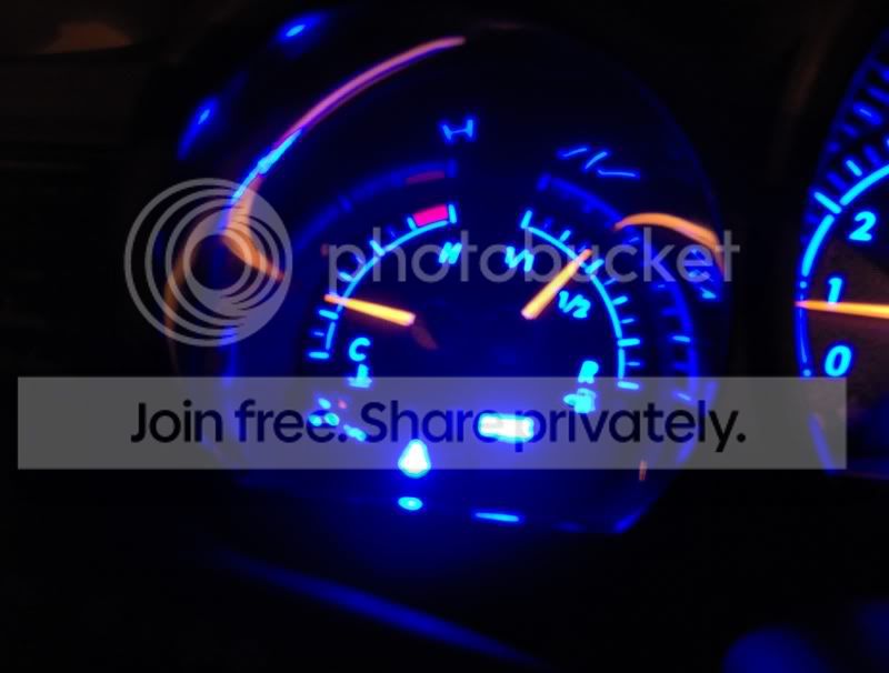

Old Apr 4, 2008 | 07:51 AM
  #134
O5_TRD_tC's Avatar
Posts: 4,790
From: Bay Area
Some of my recent swaps!

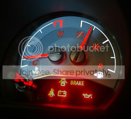

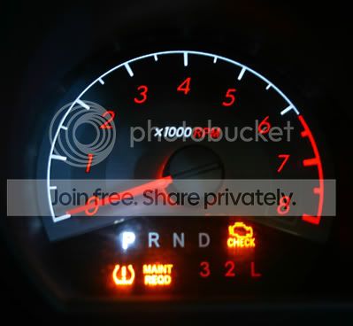

What did you use for the two-tone? That's the exact color I wanted, but the stuff I used was too light...so I triple layered it and it came out a little on the darker side.
Old Apr 4, 2008 | 03:20 PM
  #138
ChrisLilja's Avatar
Posts: 218
What color did you paint your needles?
Or did you just remove the paint, and have a white led on it?
Old Apr 4, 2008 | 03:35 PM
  #139
CarbonXe's Avatar
Posts: 16,638
From: Parsippany, NJ
^ Looks like white paint with white LED's.
