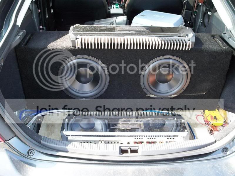

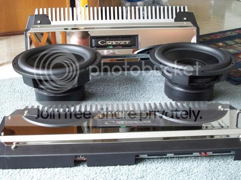

final pix to come within a week or so, getting close to done. amps will be mounted permanently sometime tomorrow.
Headunit: Alpine CDA-9887, running active
Amps: 2 x Cadence TXA-600.4 (150x4 @ 4 ohm for mids/tweets, 600x2 @ 4 for subs)
Midwoofers: 2 x Mach 5 MLI-65
Tweeters: 2 x Seas Neo 27TFFNC/G
Subs: 2 x Dayton RS HO 10's
Deadening: eDead V1SE²
Enclosure: .7 net per sub @ 30hz using 3" aero ports

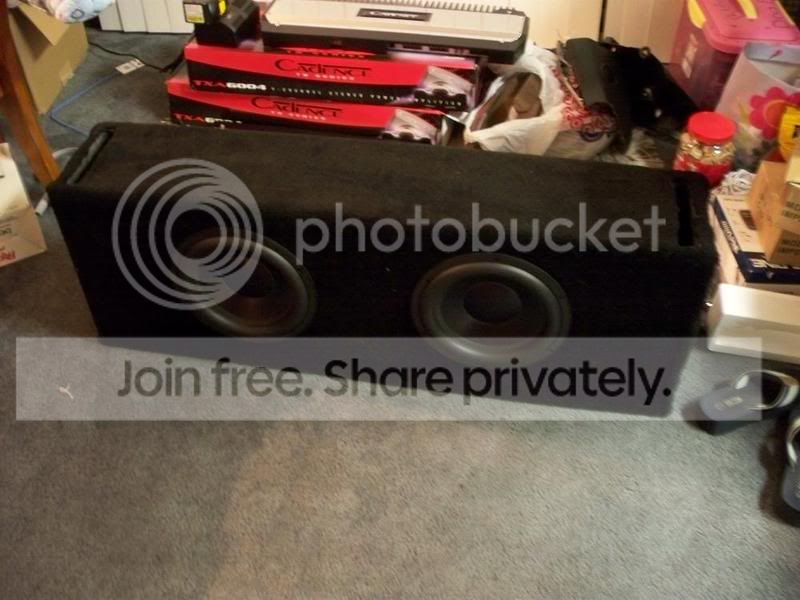

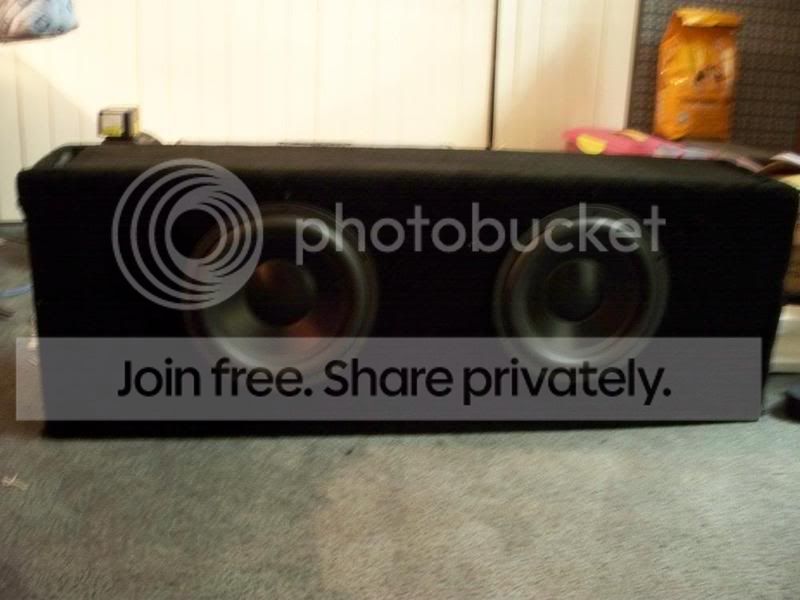

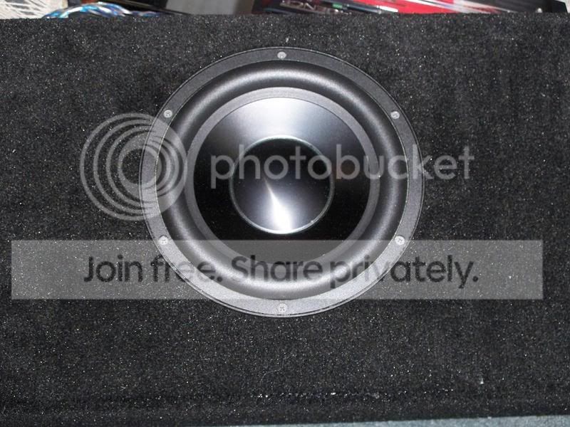

the victim...

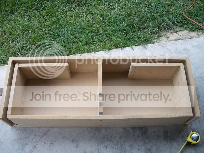

well its not the prettiest thing in the world, first time ever building a box on my own, in the past ive always had the help of my buddy who does carpentry for a living, so anyways, dont flame me too bad for my woodworking skills. as u can see, the carpet i got obviously didnt work too well, i can make carpet look pretty good for what its worth, not pro by any means, but typically a hella lot better than this came out. maybe ill re wrap it someday. anyways, hears the pix, im about to headout and try to get the rest of this thing complete

box is good but i would have done sub up ports back.

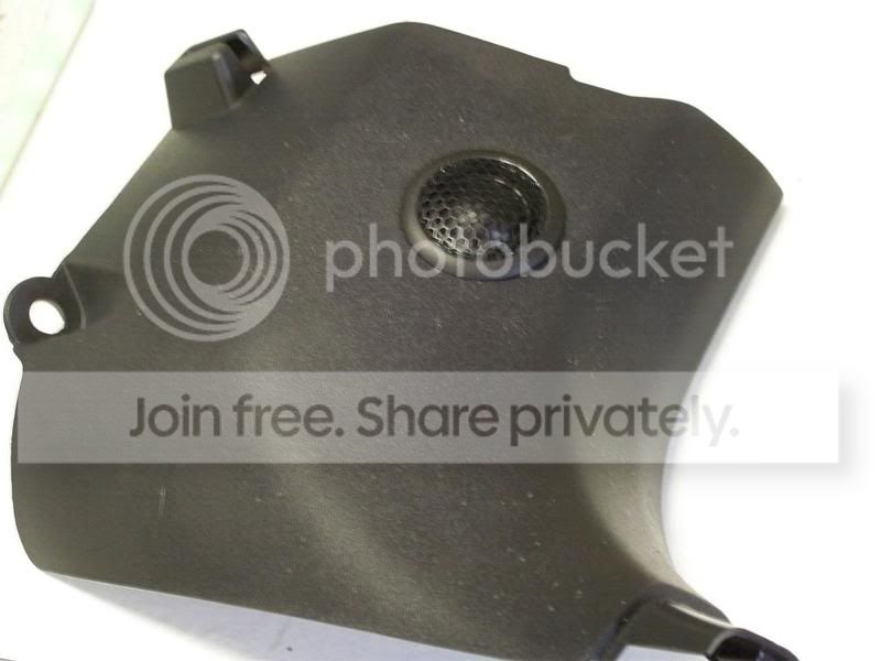

Everything looks good so far but you should have mounted your high's up near the a-pillars for optimum sound.

why? it sounds great like it is... plus it wouldnt work with mounting the amps and all, i tried everything, i got it down to lookin pretty decent id say... sounds hella good.

thats not true, not entirely by any means, down in the kicks they sound real nice, in fact, once i can get them on axis it will be a lot better. the main problem people have with having them down low is stage height, with a lil t/a i got mine up to the center of the dash right about where the top of the radio door is.. its where it sounds best to me right now... its only been installed a few days, so ill get it good b4 long, especially once i get the tweets on axis, or a lot closer

As long as everything sounds good to you that's all that matters. I was referring to sound staging when I made that comment. I've just always heard people say to mount tweets up high but as long as everything still sounds nice, rock on.

yea ur right, most people do, alot of people dont have the EQ and t/a capabilities on their units though, actually, even down there, i still have them attenuated slightly, i have the mids 80 - 2.5k/12db and the tweets at 2.5k+/24db.

Damn those are some thin ports. And .7 ft^3 per sub? My 10" has I believe 2.75 for it haha
Well your "10inch" has enough space for some 15s...

yup, the dayton ho's work best in very small ported enclosures and somehow still get damn low.
they are also pretty efficient but have a lowish xmax so they don't need a huge port.
very kick ___ subs.
