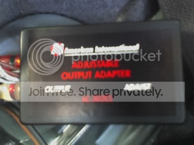

Did you ground the line output coverter? If you did, don't do that, its not supposed to be grounded.
Also make sre your RCA's are not pinched somewhere, that could possibly set it into protect mode.

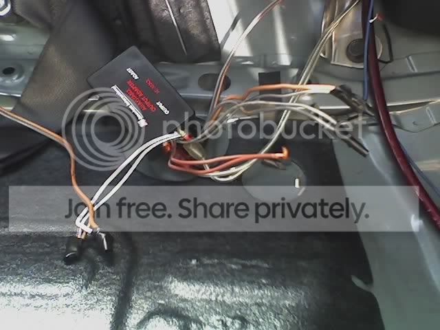

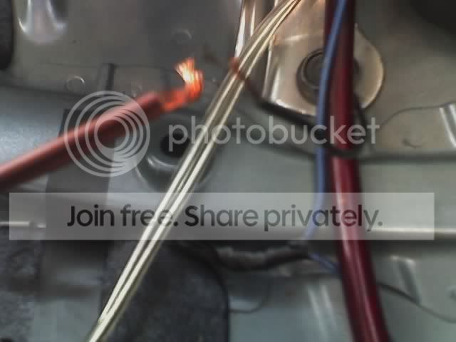

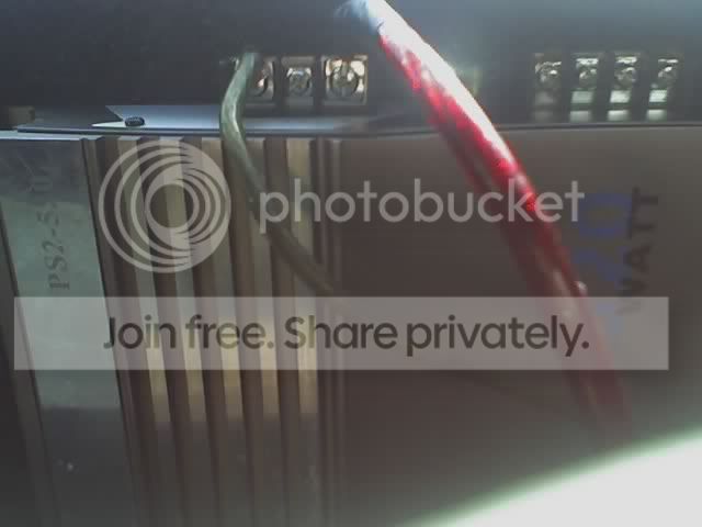

Amp conncetion
White wires, right speaker gray wires, left speaker. RCA on the other side... and the brown wires are ground.
Converter
Ground for the converter

I don't see a remote wire going to the amp, you need that to have the amp turn on.
Also make sure that you have the RCA'a on the "input" and not the "output" on the amp.
But I would still not ground the line out, I have never had to do that with any car I have ever installed on. I have been installing at Best Buy for 3 years.
Another thing I see is that you have a 4 guage wire going in as your power, and an 8 guage wire for your gound, thats no good.

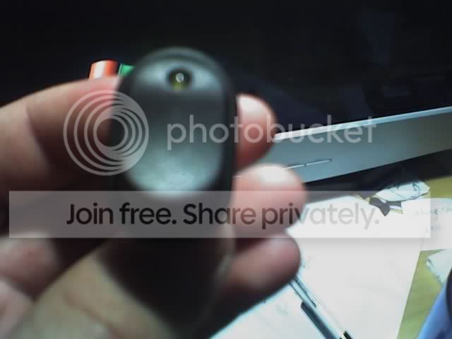

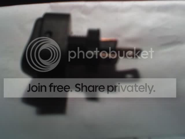

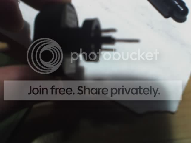

ok i found out the problem. it was the amps ground.. WOW so stuped.. now one other problem. i connceted the remote wire to a constent feed in the back of the radio. i don't wanna take out the radio (to much to do) so i bought a button. how does it work..? i out up some pics of if.
thetre are three conncetions on the back. which one is the plus? ground? and etc.

If you do want to use a switch to toggle the amp on or off, like I did, you need all three terminals on the switch connected. You need a 12+ power wire to one terminal, another wire that heads off to your remote wire, and a ground. Normally on a switch you dont need a ground, but b/c you have an LED you need to have the switch gounded. I installed a switch so I have use my subs when my wife is not in the car.

well i just founf out that i don't even need a ground for oyu.. if u see the picture of the switch, it had three connections on the back. what i did was put the remote amp on the top connection and the power on the bottom, left the middle one wireless.. and it actually turn on.. I WAS LIKE WOW!!! i'll post the picture of it up so anyone could go ahead and do it,,
