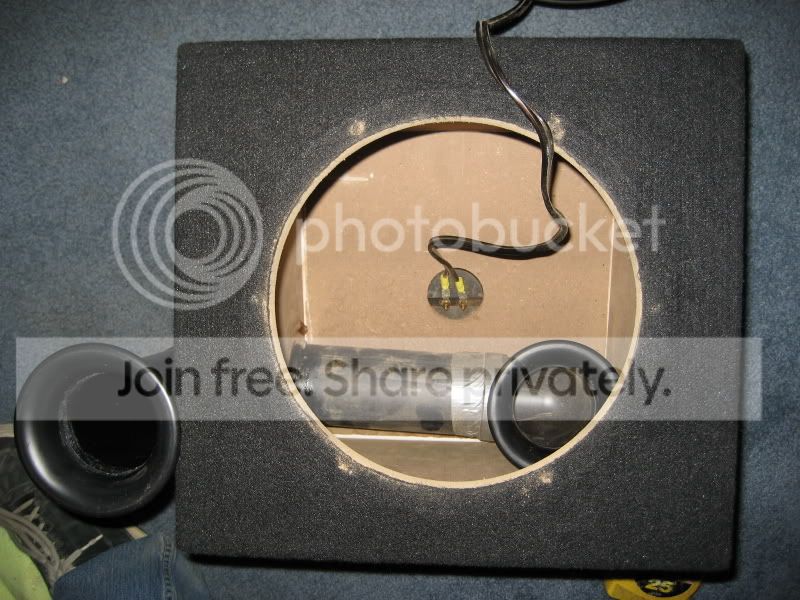

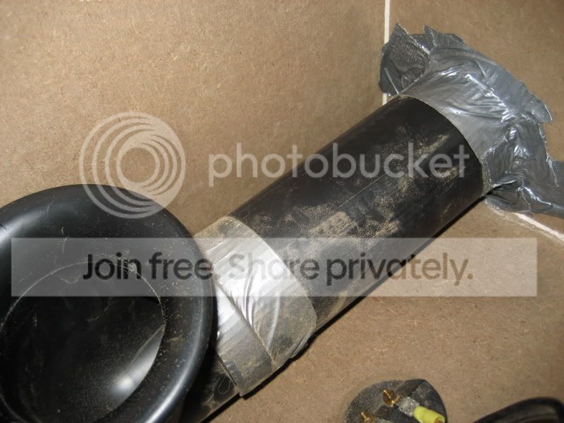

My new completed setup. it consists of:
*Head Unit: Pioneer DEH-7800MP
*Front Stage: Phoenix Gold RSD65CS comps, Deadened and sealed doors with Edead V1SE
*Amps: Kicker ZX750.1(sub), Kicker ZX550.2(comps)
*Sub: Dayton Reference 10 HO subwoofer, in a .72 cuft (net) ported box tuned to roughly 28-30hz

You just jimmy rig that port up?
It looks like itd make it a lot more powerful...
Wonder what itd do to my w6

well i don't know what you mean by "jimmy rigging it up". but it was planned out and it's tuned correctly and all that. it sounds amazing. this particular sub likes a .7 cubic foot box ported. good luck getting an entire 25" long port inside a box this small. some of the port is external, and some is inside the box. i'm not the first person to ever do this.

CAI for the sub box...very nice j/k
looks good man, nice setup

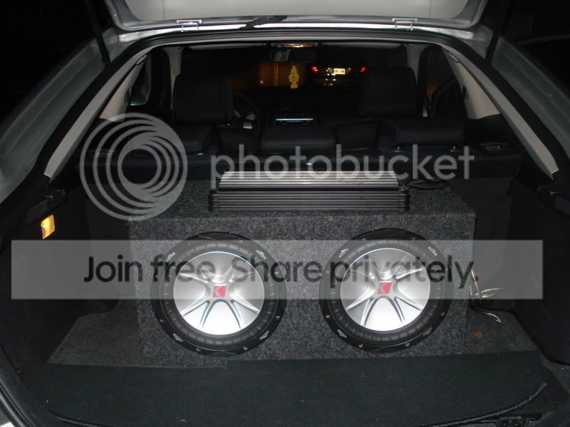

i'll have my new system pics up soon......
Pioneer AVIC-D3
2-Kicker comp VR10's
Kicker ZX750.1
Kinetik 800 power cell batt

finally it got done tonight.... and finally got the problem of the subs cuttin out fixed.

Lookin good dude! but are you going to try and hide the powercell?

its well hidden the seats go up and made a top flush panel that makes the box look huge cuz it goes from the front of the box to the seats, so everything is hidden. all i can say its a lot louder than my 2-8's and very clean sounding as well, i just need to tune it better

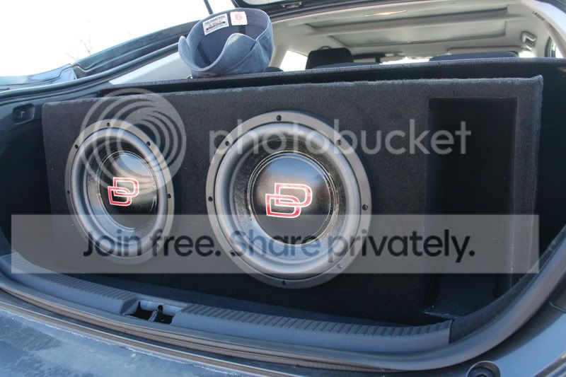

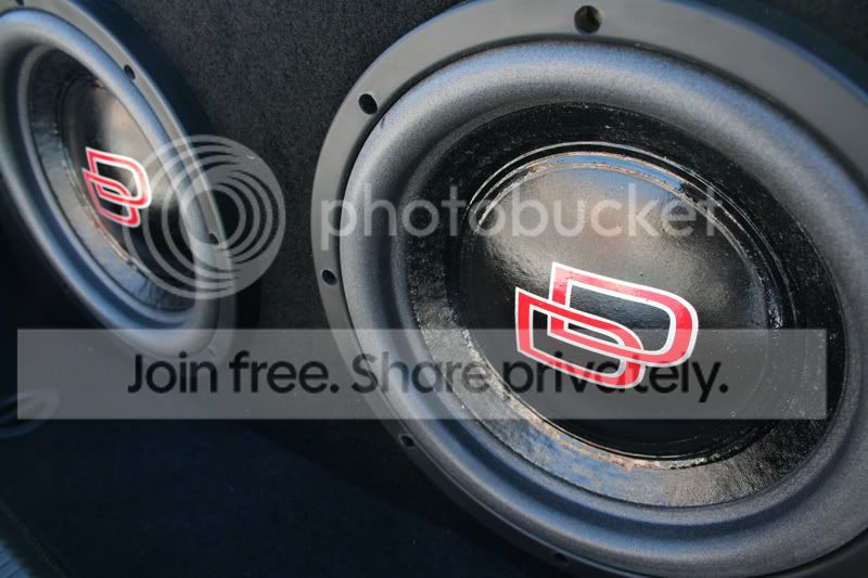

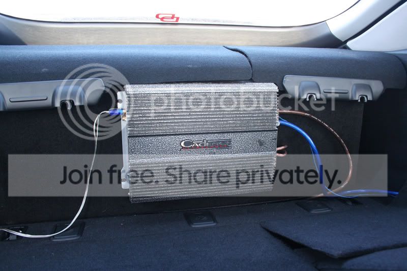

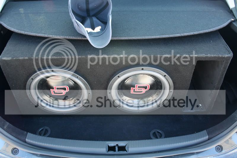

These are Digital Designs 1510s. The box is 3 cubic ft NET, tuned to 40hz. 52 sq. inches of vent.
They hit hard, to say the least. The are powered by a Cadence A7+HC (beast of an amp) at 2 ohms. They are taking everything the amp gives them like champs and barely breaking a sweat while doing it. This was my first box building experience, so I'm pretty pleased I was able to even get the calculations correct, let alone cut and construct the enclosure.

^^ not bad at all.

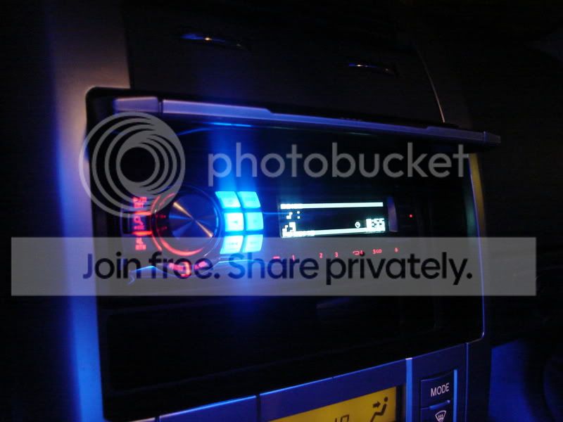

Here are some recent profossional photo I had taken of my system courtesy of Ride21modeling.com
In this first pic, the reason that not all the numbers are showing up is because the refresh rate of the LED display was not fast enough for the camera.

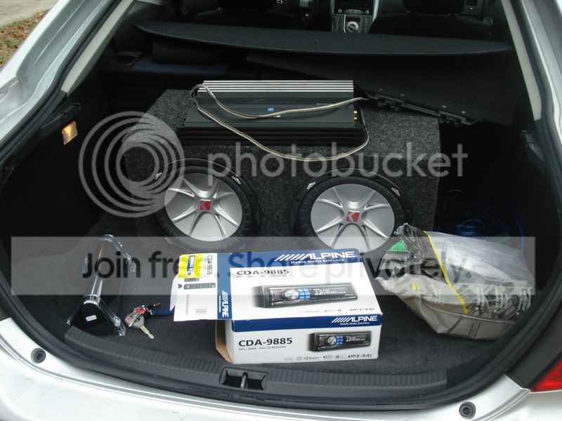

Just Installed!!
Started with this
Before I got it installed, you can see the subs better....

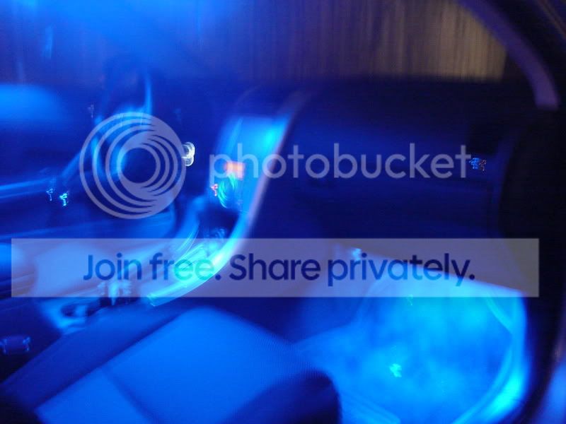

and a pic of my cathodes (I love Oznium! lol)
