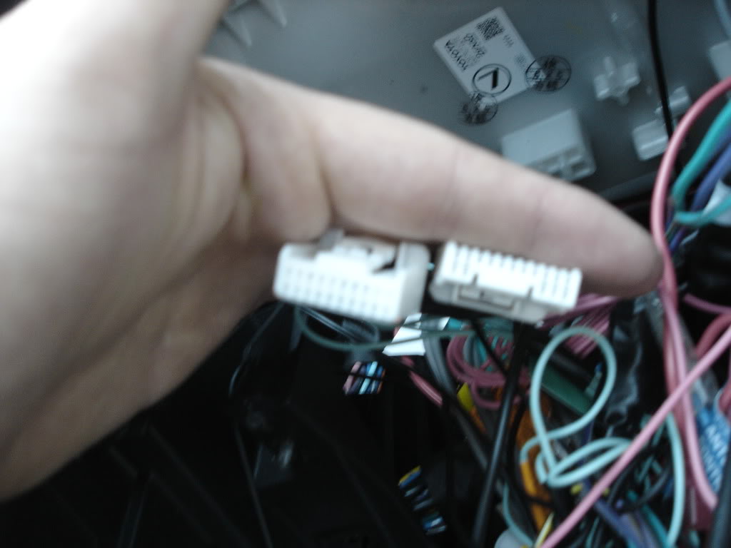

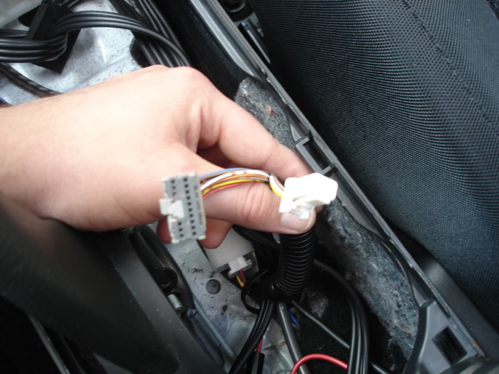

OK, Sorry for the delay. Been buys with work and also lazy about taking my car apart.
So here is the back of my OEM radio:
Here is a shot of the plugs that go into the arm rest area:
Here is a shot of a connector box in between the shifter and the arm rest:
Shot 2:
And now the plugs behind the radio:
Let me know if you need more shots of anything. I know some of the shots are blurry sorry about that.
