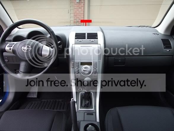

I want to mount my radar unit fairly low on the windshield, right above the dash essentially. I plan on hardwiring the unit, but would like it to be discreet. Is there a way I could sneak the wiring underneath the center of the dash? I would prefer to do this without taking apart the entire thing if it's possible.
So, thoughts? Here is a quick picture of my planned mounting location:

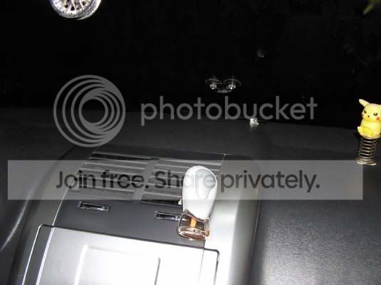

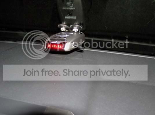

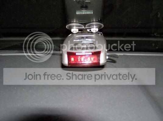

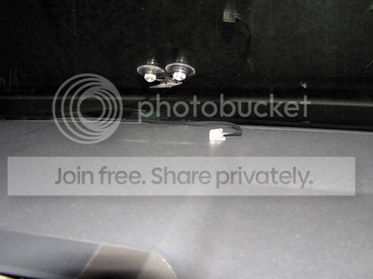

i will post pic of mine, tomorrow

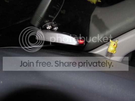

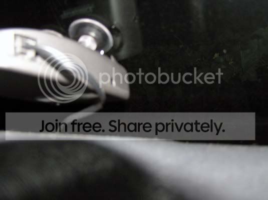

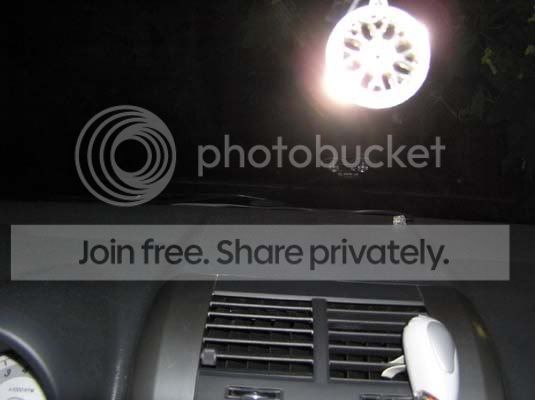

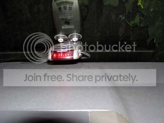

I tap the power wire from my headunit.
The wire run under the steering wheel. Then up to the A pillar side.
I just push the wire under the windshield with a cd.

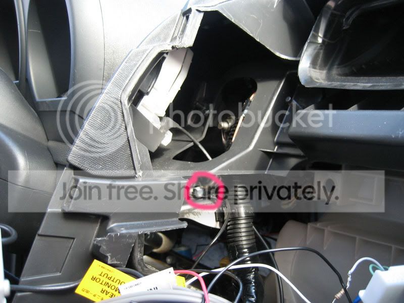

One other thing I just thought about: where did you guys put the ground from the hardwire kit?

Well you can actually ground it with the cigarette lighter... meaning if your taping into the power source, you might as well tap into the ground as well. If you do it to the radio same concept. The wires are not going to be as easy as red for positive and black for negative though. OR final option you can actually ground it to a clean metal surface. Let us now where you are going for power and I can get wire colors for you.

stole this pic from "Phanon_TC" 's D3 install.
I ground my radar here.
