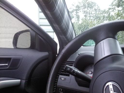

http://i1137.photobucket.com/albums/...redownload.jpg

thats sweet man..i redid mine with 3m and i swear the first hot day like 100+ the headliner let go in some spots

thanks dude. yea that happen to me but you cant really notice. i just hope it doesnt get worst
