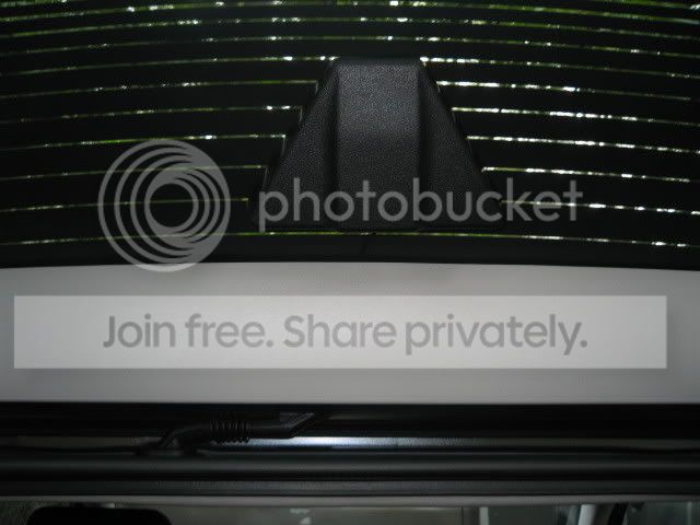

Took some pics this morning, I hope you can make everything out.
Here is what the antenna looks like on the actual hatch glass. When the hatch is closed you can't see it at all from outside, and I can't see it in the rear view mirror.

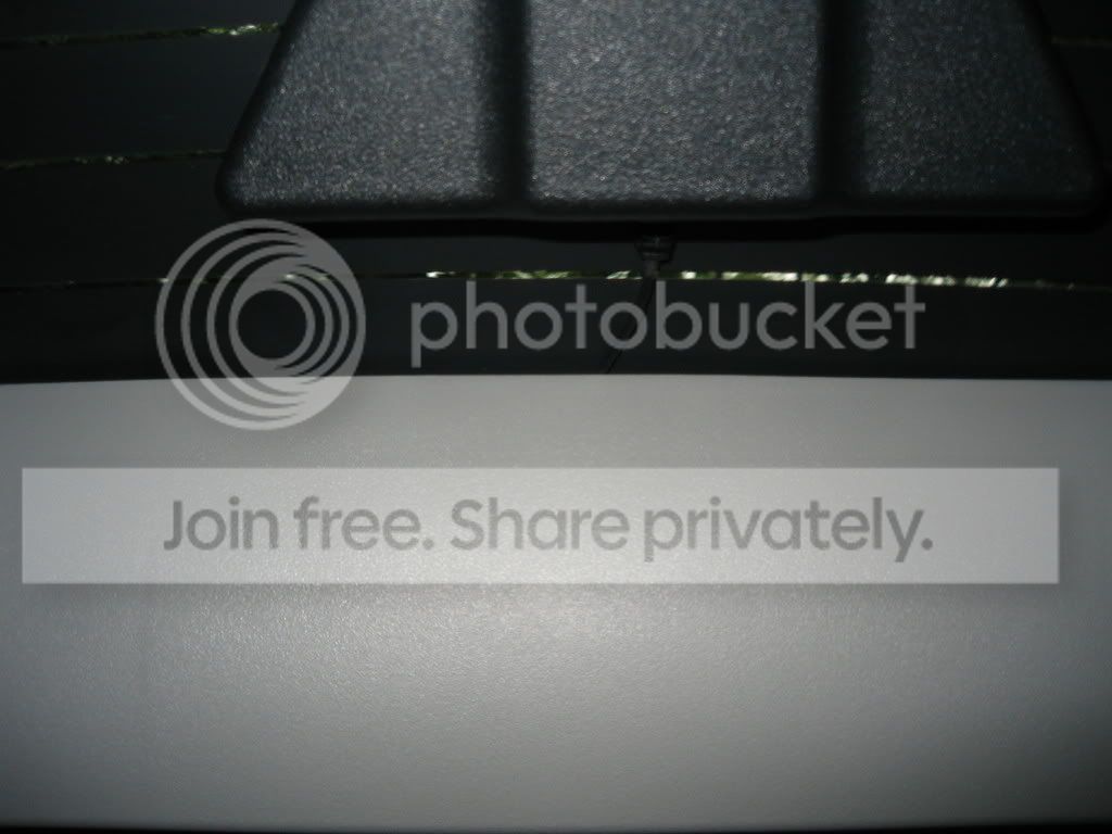

A little bit closer; the wire runs under the gray trim (which pulls straight off) and into the rubber sleeve into the car/headliner
The antenna wire running beneath the trim.

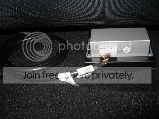

I installed the Sirius box under the front passenger seat, which is the factory Toyota location. I'm not too concerned about dust, etc. as the box is sealed (it has no vents of any kind). I figure Toyota knew what they were doing.
The pic below is with the front passenger seat moved all the way forward. With the seat in it's normal position you can't see it at all. The fit kit includes a template of where to mount the receiver.
Hope this helps!
Hope this helps!
