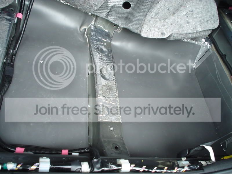

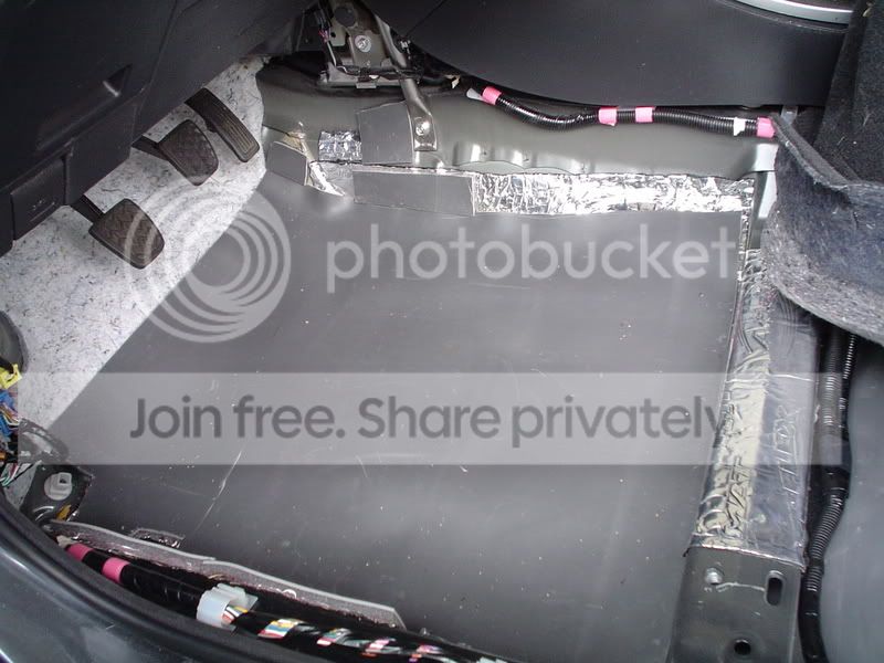

I think 'goop' or any form of liquid sound damping material is far too messy and a hassle to work with.
I feel the least important surface to dampen is the roof and hatch. Damping the vertical surfaces (doors, quarter panels, etc.) in the tC, as well as the floor is going to yield the best results.
Here are some pics of mine:

Thanks for the pics Rocketgyrl! It always helps me see/hear what you are talking about and get ideas.
Hmm..interesting. So far not a single sole has liked the liquid versions. It seems like cutting, using a roller, and applying constant pressure would be more demanding than using a brush and thick paint.
