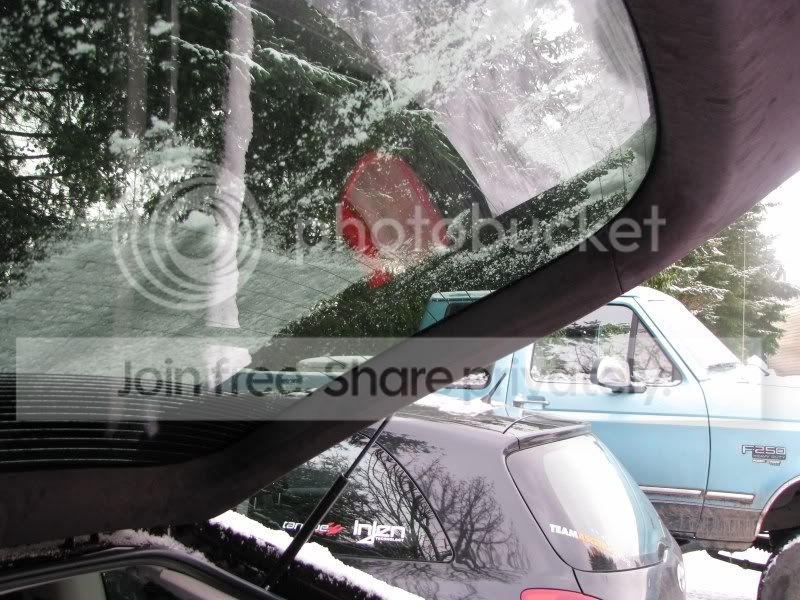

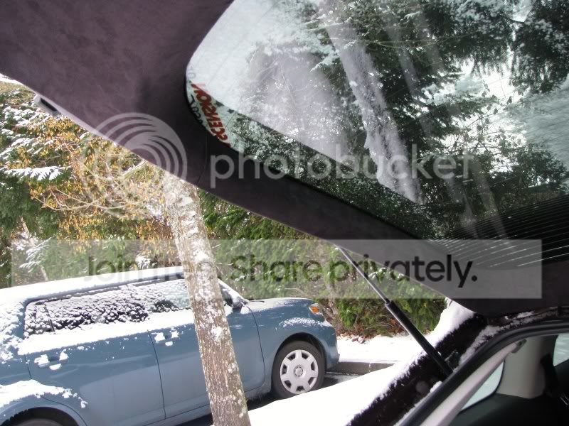

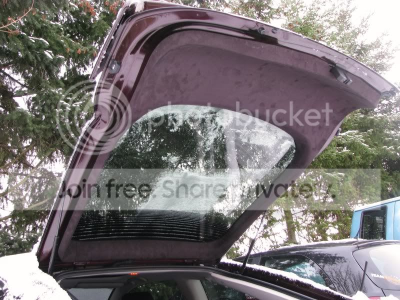

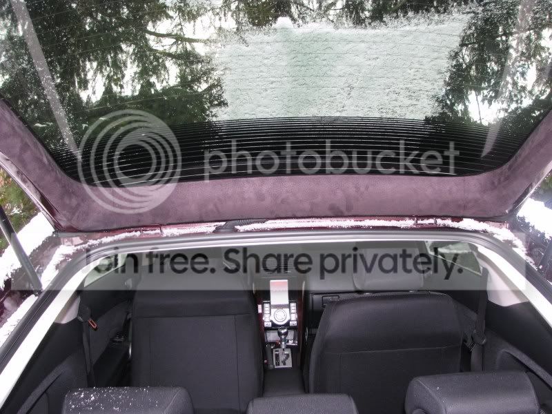

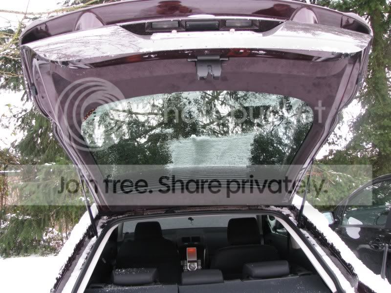

took me 15 hours to do the hatch but I got it....I screwed up and got a bad wrinkle in the big hatch piece and had to tear it all off at about 70% complete....really sucked
got the rest of the car to go but I cannot get to the garage to work in the ice and snow and I have to gut the car again to get all the pieces out.
Here is the hatch installed........finally
sorry about the finger prints need to wipe it down....lol
About 20 hours into the headliner,and a good 2-3 hours into each piece......
I hope to never have to do this again in any car.......I still have to reinstall everything this weekend and will post up pictures of the finished product.
I also still have to finish my painting of the visors,and the dome lights,and o crap handles and coat hangers.....
I will say this is not a job to try to take on if you are a beginner,it is hard to do and get expensive very fast,adhesive is about $12 a can and I went through 6 cans....total cost into this project is close to $200 in materials,and about 40 hours.

did you cover the pull handles on the inside of the hatch too?
Old Dec 19, 2008 | 09:17 PM
BZinn1's Avatar
Posts: 9,538
From: Washington
Yeah I never use them,I was gonna cut them out and actually did on the first panel that got scrapped and it did not look very clean.panel actually stays in well just with the clips and no screws.

Hopefully you never have to replace a taillaight bulb, the license plate bulbs, or third brake light. That would suck. Looks nice besides the possibility of having to take it off though.
