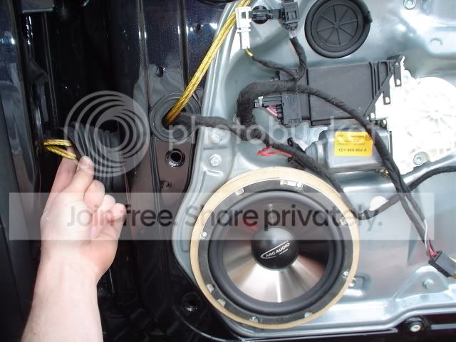

I'll do my best to simplify it for you...
Here's what your rear speaker mounting locations look like (ignore what I'm holding - and visualize your factory rear speakers in the tear-drop shaped hole):
A "baffle" is a board that you mount the speaker to. This is important because speakers vibrate to cause sound, and physics (more specifically Newton's 1st law - an object at rest....) plays a key role here. A baffle will help "mass load" the speaker, and the result is better sound/performance. Dynamat is the same idea - mass loading/damping the area around the speaker to lower resonance and quiet the car's rattles - allowing for a more efficient audio system (less energy required to fight/overcome road noise). Here's a picture of speaker mounted to a baffle:
