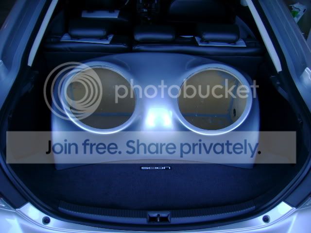

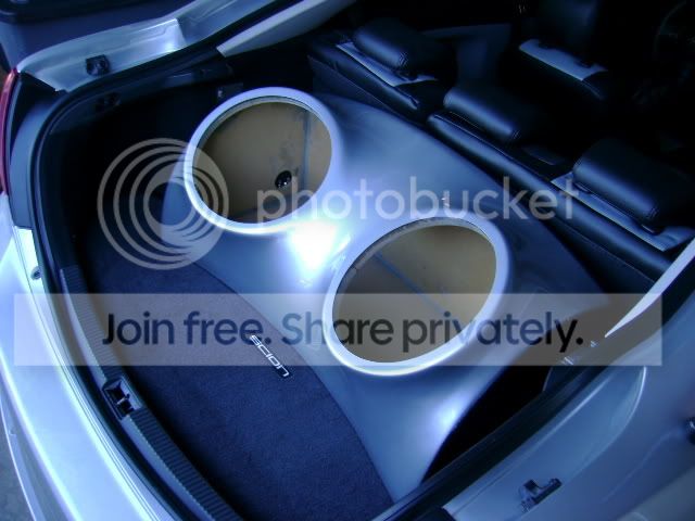

I just got my fiberglass enclosure and it is sweet! I have to wait to get the subs put in because it's going in for a turbo on Tuesday! I will post pics of everything when it's completed!
