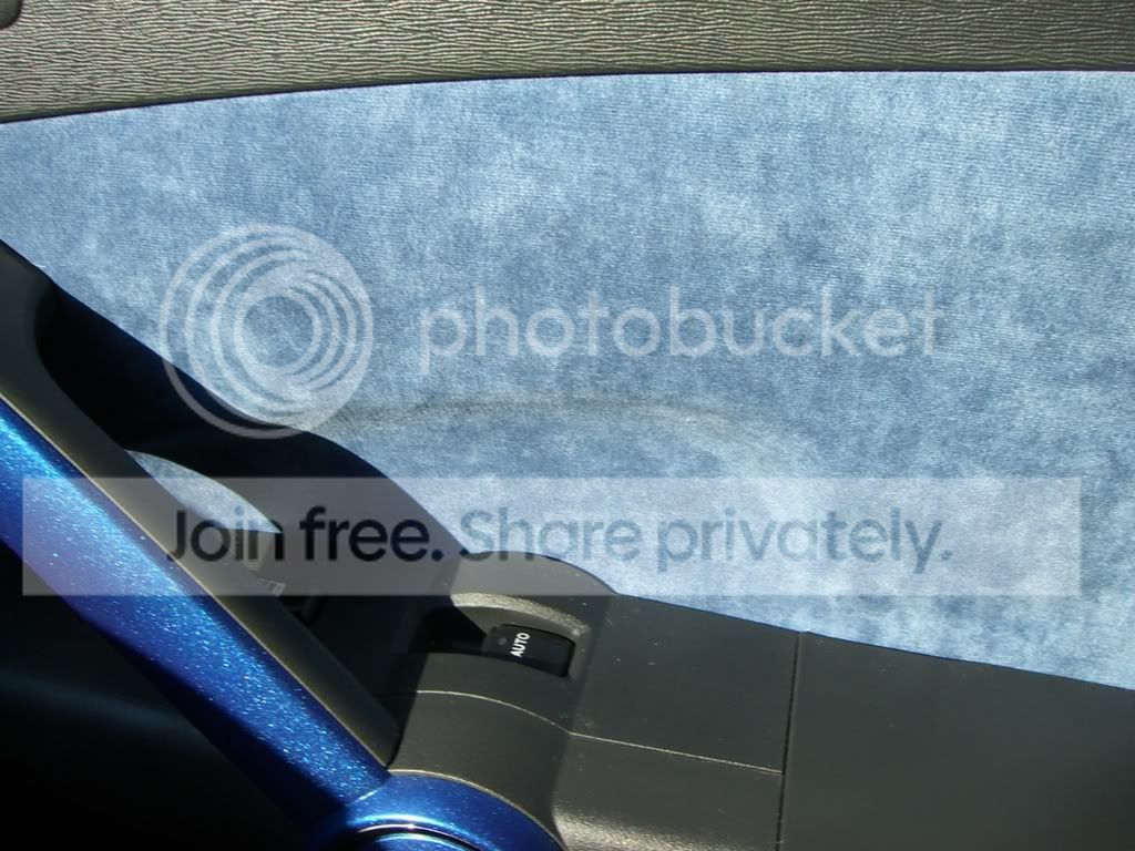

Sueded my door panel mid sections

I didn't remove the fabric, just sprayed some 3M adhesive trim, layed down the suede and folded over the edges while smoothing it out. It's pretty easy!
To put the middle piece back in, just get a hot glue gun and glue sticks and while pressing down, re-glue the holes and it dries quickly.

everyone says they dont like the color but i think it flows a little better than the black. I am really diggin it right now, and if you like it then that is all that matters. Let us know if you decide to do the back!

ok so heres the finished product and i know some of you disagree with the shade of blue but again thats the best i could find
Bravo!

good job, looks much better now...i just got done w/ mine...did you do the panels in the rear too?
