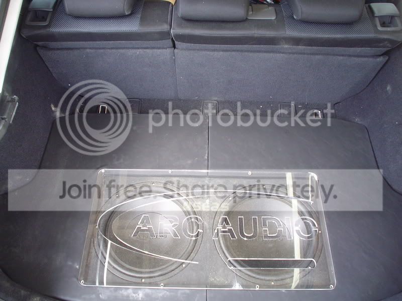

I choose to remove the spare tire, and utilize the well for the bottom of my box. I made a frame about 35" wide, and 26" deep. The side that's closest to the rear seats is 5" and the rear is 6". The fiberglass bottom is about 3/8"+ thick. The top is 3/4" MDF. We've calculated the internal volume to be 2.6CF, good enough for the pair of 12"s. The Arc Audio logo was laser cut in 3/8" plexi glass. Everything was wrapped in grian and color matched vinyl. The factory tC trunk mat still fits over everything. There's another grill that's more durable and less "flashy" for regular daily driving - allowing me to throw groceries or luggage on top w/o worrying about the subs.

Here are some pics:

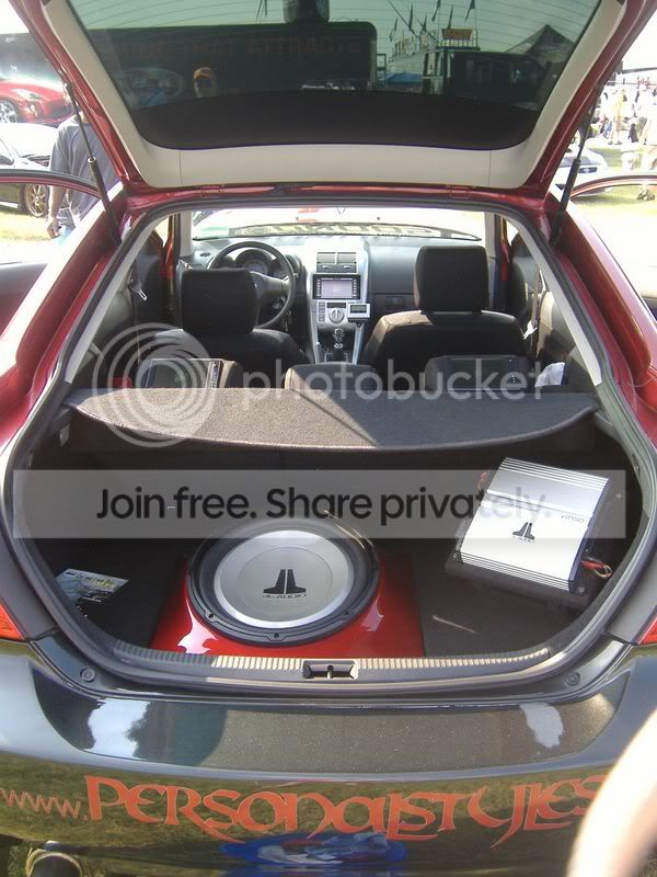

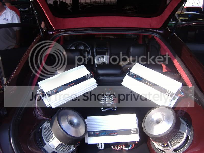

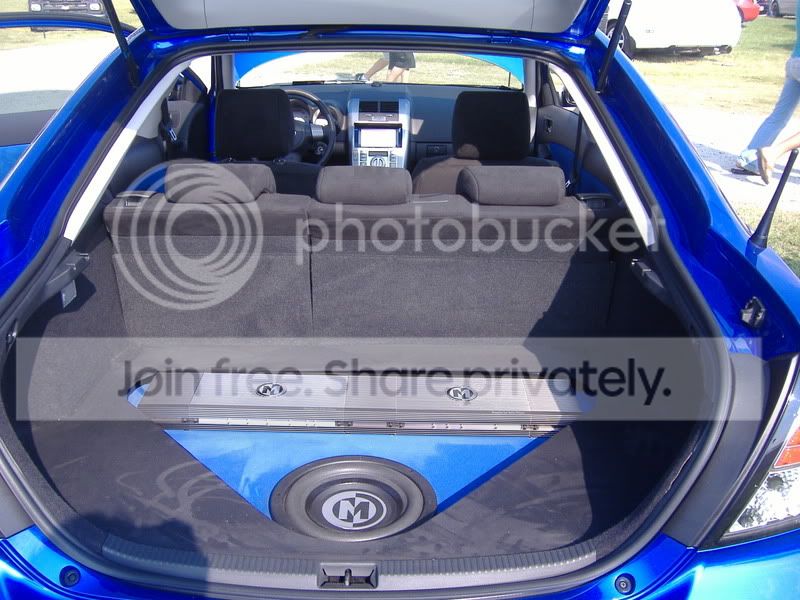

Here's some tC's that were at IASCA World Finals - not exactly what I would suggest because they void the trunk of it's practicality, but you'll get some ideas:
If you want to keep a flush, factory look - especially with a 'normal' (re: not shallow) subwoofer, such as your W6, you're almost forced to use the spare tire well, or build it into the corner.
I've seen other members build these style boxes on here - and hopefully they'll chime in with how they did it. The obvious way is to build the floor piece out of 3/4" going around the perimeter of the trunk and spare tire - essentially where the factory foam is. Build another piece going vertical up the passenger side wall - forward of the tail light and behind the rear seat. Build a baffle for the subwoofer and use glue and some dowel rods to set the angle for the sub. Staple and stretch fleece over the ring to the back and side of the box and apply fiberglass resin. You'll end up with something like this:
