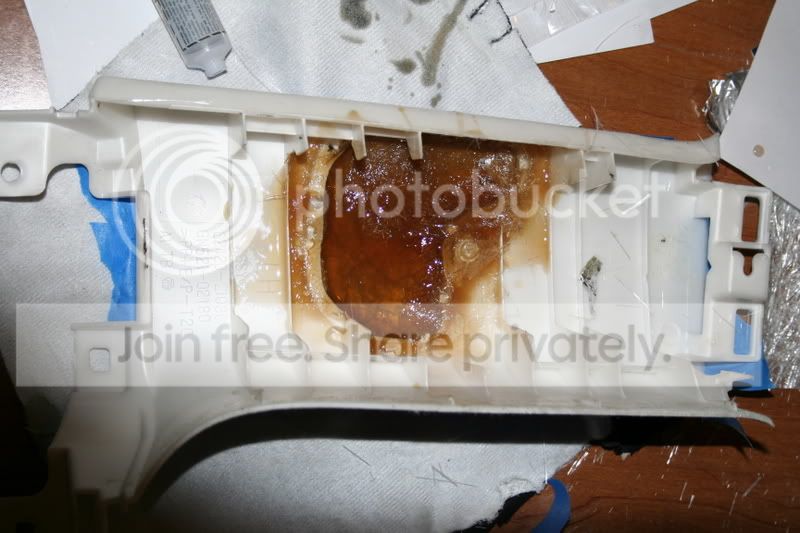

well i just thought i'd show you guys a little project i did today. I haven't sueded them but with the addition of my racing seats the stock belts were getting in the way so i decided to take them out. I plugged up the b pillar with some glass and filled and sanded it down and they'll be wrapped and installed tomorrow.
Not very huge just a little addition i thought was kinda neat

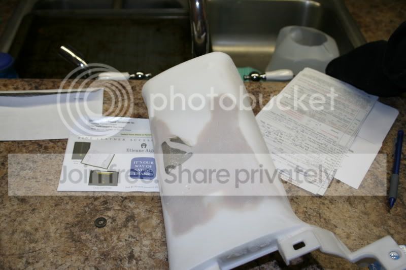

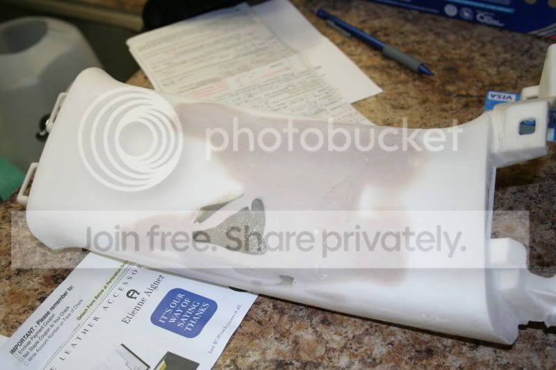

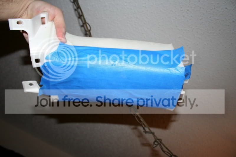

well here is how i did it.
should have them wrapped in suede and installed by tomorrow
and from there its a couple of coats of bondo and sanding to make it smooth.

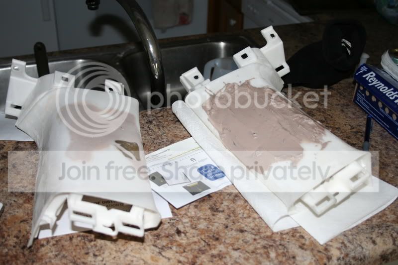

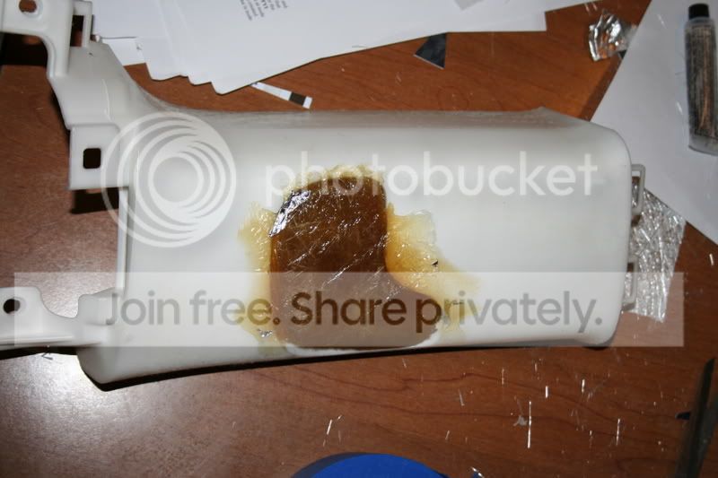

and after 30 min of curing its time to pull off the tape and foil
as you can see its pretty flush but needs a sand and a body filler so here i go. lol

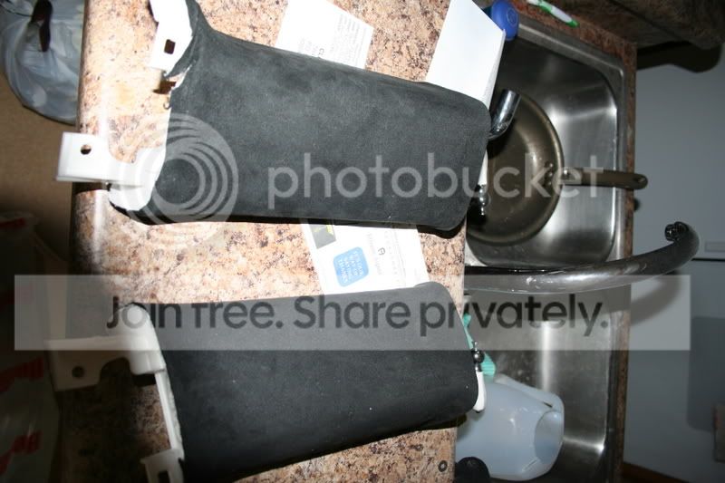

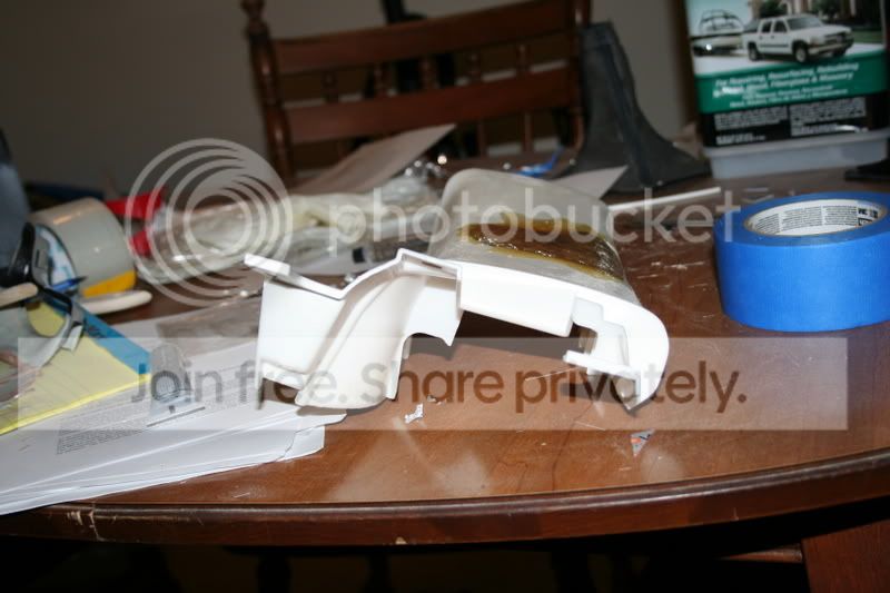

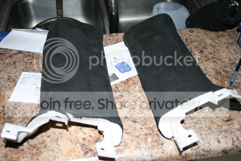

and now its done.
total about 5-6 hrs in the project (a lot was curing and sanding) but i think they turned out good. here are some more pics.
other one filled ready for sanding
finished
