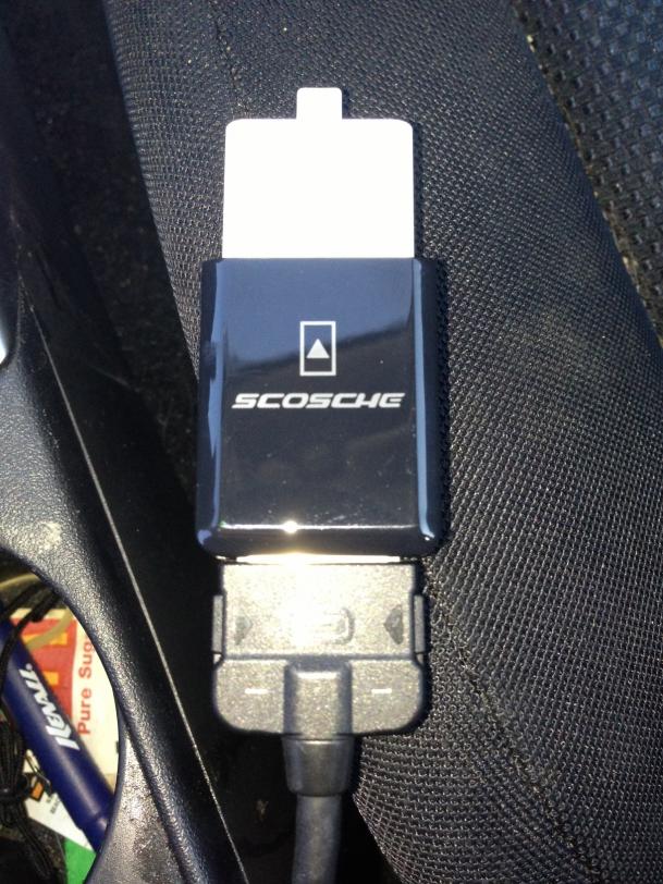

You have to get the Scosche adaptor as well. it goes in-between the car cord and the iphone 5 adaptor. I've attached a picture of what it should look like now.
The adaptor you need is: http://www.scosche.com/consumer-tech/product/1667
It doesn't say for iphone 5, but it does work. I'd take a picture of it charging my phone, but I use my phone to take the picture.
But the adaptors are all over ebay/amazon. Most are around $15. Just make sure it's Scosche and not an imitation!
Now with the Scosche adaptor and the 30-pin to lightning adaptor, you can CHARGE and PLAY the iphone 5 through the factory unit.
