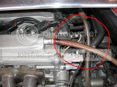

So I pop the hood and notice a weird low humming sound coming from somewhere in the engine bay, it sounds like it's coming from the circled area:
So I wiggled some wires/connectors around and then try to start the car again. Still doesn't fire, but the noise went away.

what i want to know is what are those hoses for?

The hoses go to an oil catch can. It's normally the hose the recycles extra oil back into the intake tube down into the throttle body.
