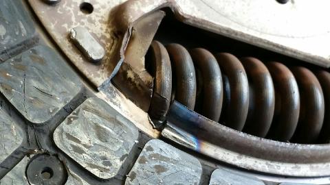

ok well, after further inspecting I think this was the problem a chuck of metal from my oem clutch disc broke off. I'm guessing that this metal got jammed somewhere in the clutch mechanism not allowing me shift. some photos below..
I bought a new clutch from pepboys but it was a cheap clutch to get me going again. I hope i didn't make a mistake of buying a cheap clutch.. luk brand from pepboys( seemed a lot less heavy duty than the oem toyota clutch)
