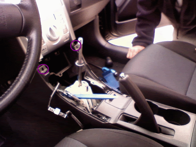

To access your parking B-R-A-K-E start by removing the Shift ****, and pulling the plastic that line the sides of center console. They may be a little hard to pull off, and don't pull too hard or you'll pull off the cigarette lighter connections. You will have to detach the connections to the cigarette lighter which has a few pins attached. Once all of this is off it looks like this.
There should be screws where those purple circles are unscrew them.

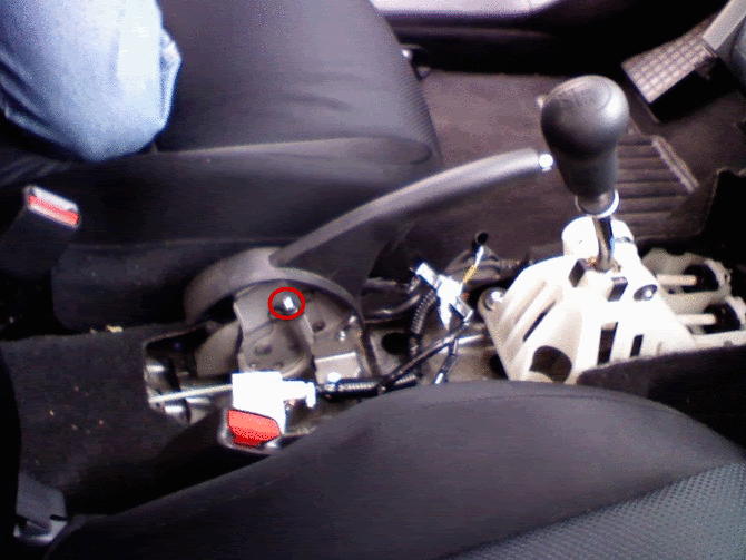

Now look into your center console glove box. Under that rug is a couple of bolts. Unscrew those too now your whole center should feel pretty loose. All that is left is to unplug the wires connecting the Ipod/Aux cords in the center glove box. You'll have to reach down there and unplug those. You get this:Name:  lunapic_126802674670893_5.gif
Now if you look at the red circle that is the bolt for the cable to tighten the B-R-A-K-E. As you can see mine is very short in this picture and the B-R-A-K-E doesn't engage until very high. So you have to remove the safety bolt on top then tighten the bolt underneath which will bring the cable up tighter.
Now you can see how much more of it is showing. You don't want it too tight other wise your wheels wont move when the B-R-A-K-E is disengaged. So you might wanna jack up a rear tire and make sure that the tire moves with ease while the parking B-R-A-K-E is off. You also might want to drive and make sure you cant hear the beak while coasting and fiddle with it until it is just the right tension. Hopefully then helps those of you who wish to fix that loose hand B-R-A-K-E! A good parking B-R-A-K-E should engage between four and six clicks.
