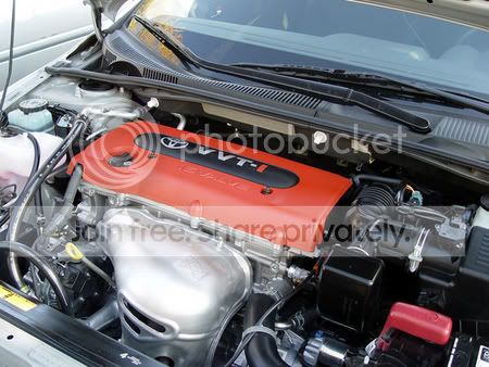

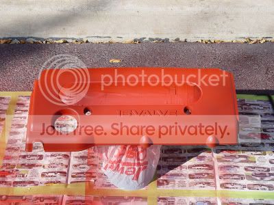

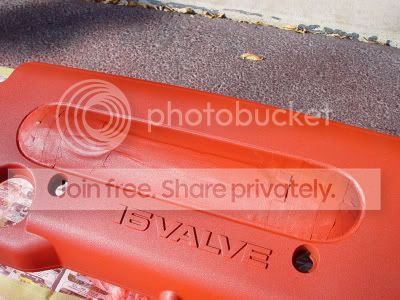

After reading a thread here a few days ago, I decided to paint my engine cover. First, I scuffed the plastic with finishing sandpaper to give the primer something to grip. Then I did 2 light coats of Dupli-Color red primer, followed by about 3 or 4 very VERY light coats of Dupli-Color Ford Red. This ensured a rough crackle-finish similar to the Honda Type-R cars. I can't remember whose thread that was, but thanks.
A few pics:
During painting
Close up (notice I decided to leave the "i" red) :
And the finished product:
As always, questions/comments/suggestions are always welcome.

how does the cover come off? just pops?

I think on a tC it's just 2 bolts on the top....10 mm and if you just drove, very hot!

Yeah it's the camera. I didn't have time to autolevel it in PS. In real life its bright red.
400amonth, I used high-heat engine paint, so it should be fine.
Sal803, the cover is held on with 2 10mm nuts. After those are gone it just lifts right off.
