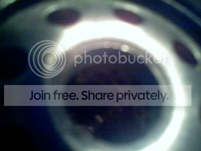

Do me a favor spect2k3. I assumed that you bought a new mobil EP filter. Look into the center hole in the filter. The center tube, is it a round metal tube with holes, or is it plastic ribs?
Old Apr 21, 2007 | 01:43 AM
Spect2K3's Avatar
Posts: 3,201
From: Norwalk, CT
its a round metal tube with holes

its a cell phone picture, but its the best I can do. You can sorta make out the metal holes on the inside.
What does this mean to you?

The metal center tube is the traditional choice, used by almost everybody. Champion Labs has switched the design of some centertubes to what is called the e-core, which is based on plastic ribs.
I am just curious to see if the change have been made to the mobil1 line.
