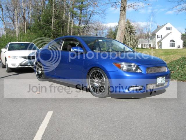

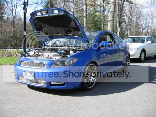

Here's some pics of my new stuff. Treadstone kit with upgraded turbo and Tenzo R 18x8s.

nice.
maybe this will end all the stupid, "photoshop these tenzos on my car" threads. lol

lol. ya i took a little bit of gamble but i like how they turned out.

rims look dope, good job, car looks good

nice...rims looks gr8!

Wow car looks sick!!! Love the rims. I just got my f/i yesterday so I excited to put it on.

Dyno's still at work, 210HP/195TQ @ 5psi, no management, AFR flat at 11.1X.

i didnt know you could run the treadstone kit with no EMS...
im assuming your still on stock injectors to then...?
any plans on getting an EMS and upping the boost?

The treadstone kit actually doesn't include ems and they say you don't need it. It came with 440cc injectors but I do plan on getting 550s and an FI/C at some point. Likely after gauges, radiator fans, and BOV though. The Greddy RS stutters because I'm running low boost.

looks good, I jus dislike the cutting of the bumper but besides that nice job

I didn't like it either. I should have been more explicit to the shop I had install it but if it's good enough for Rado's TA tC it's good enough for me. I'm going to have the shop make the left side piping the same as the right and then I'll be happy.
