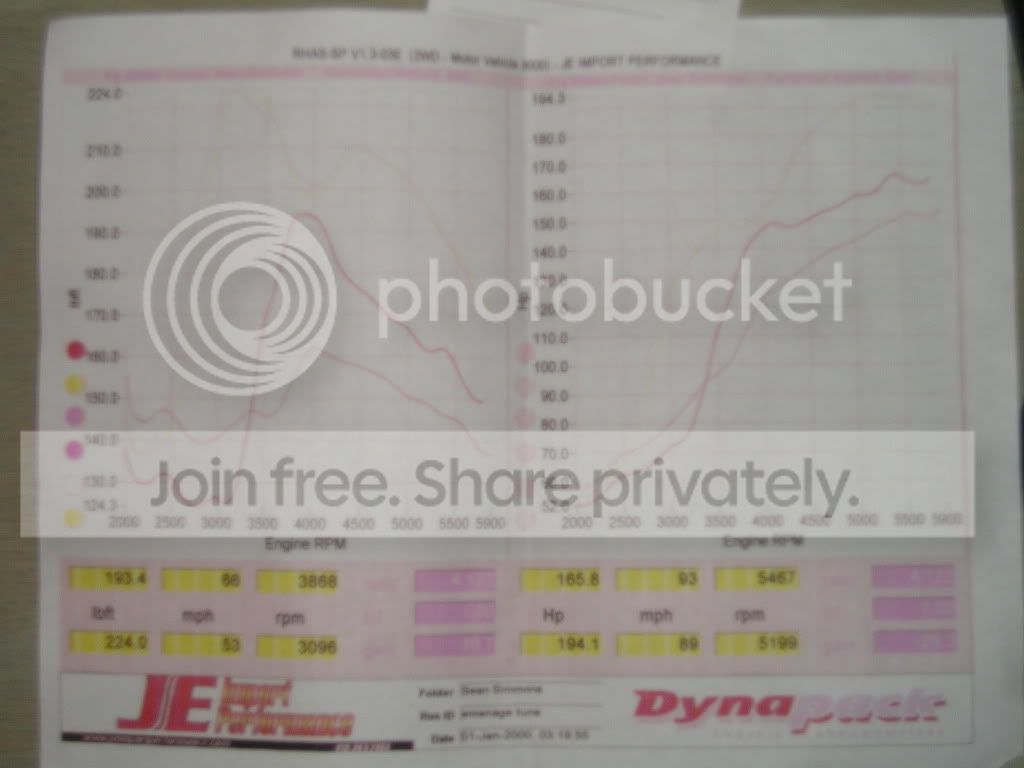

I ran a zex 50 shot and these are the #s I got

It was alright with the zex system but u ge very bored of it and u start Haveing hp fits then u go with a full blow race turbo and now i feel better.

what I am trying to tell u if u have intake exst header all the na part no internals with a 50 wet shot this maybe the #s u see
