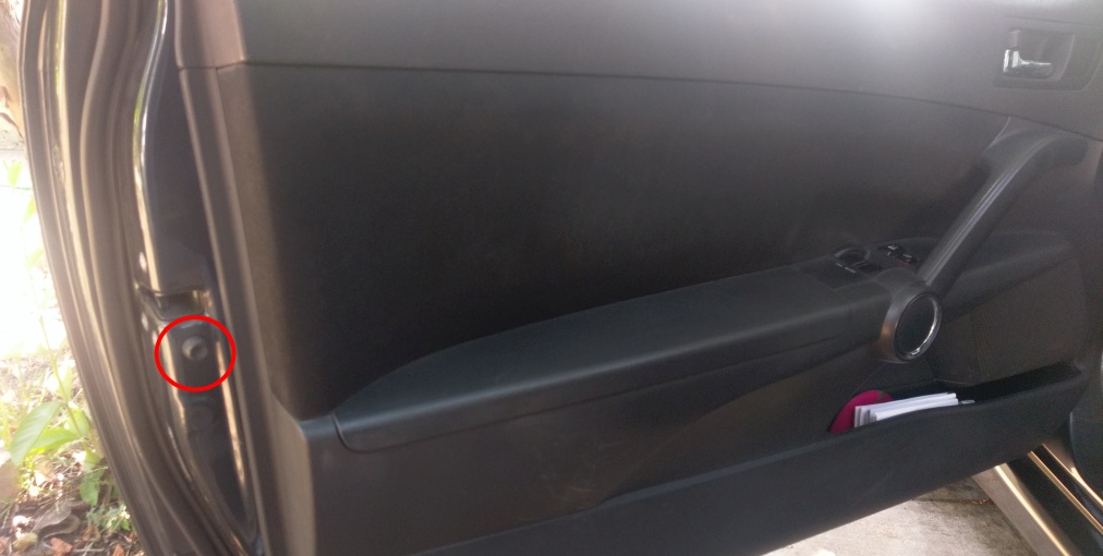

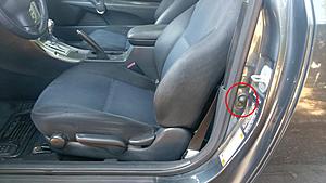

Definitely get this fixed as soon as possible. I have attached two pics. One where you see the driver car seat has the actual door jamb switch location circled in red. There will be another door jamb switch like it on the opposite side for the passenger door. The second pic shows the drivers door with the rubber stopper/plunger circled in red. There will also be another stopper/plunger on the passenger side door. This stopper/plunger pushes in the door jamb switch when the doors are closed. Either the door jamb switches are faulty and need to be replaced or maybe even missing. Or the rubber stopper/plungers are damaged or missing on the doors. The rubber stopper/plungers on the doors are easy to check to see if they are there and/or damaged. For the door jamb switches try pushing them in and out a few times with your finger and see if the door open light goes off when you do. Sometimes the door jamb switches get "stuck" internally and need to be pressed in and out a few times to get them working again. If however that doesn't work it needs to be replaced.
