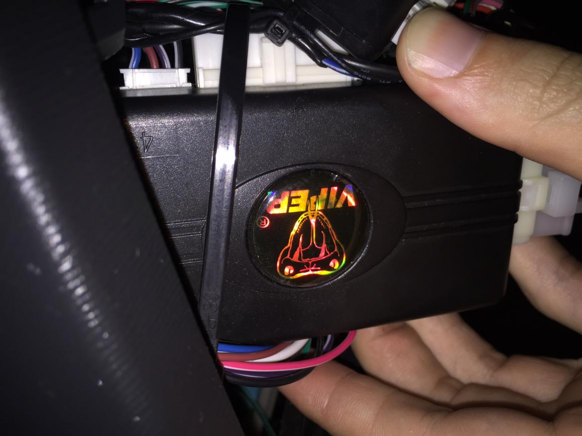

Default Are these boxes after market? (pictures)
I recently bought my first Scion, a 2008 tc, used. I'm very happy with it, but I recently came across these while looking for the fuse box (lost my dome lights). Guessing they are both after market but I want to be sure.
The larger box is a Viper 4103XV
The smaller box I'm not sure of. That sticker seems to be all the information there is about it
Any insight/input/suggestions on what to do now would be much appreciated!

Not sure what the smaller box is, but the box with the viper is obviously for a alarm. Maybe the smaller box is part of it as well.

I realize this is such a late reply, but those boxes are for a Viper Remote Start System. The 4103XV is the remote start itself. The other unit is to bypass/disengage the immobilizer so the car will start. Most modern cars have a chip in the key, which prevents the car from being started using a simple copy or by "hot-wiring". The chip is needed to activate the ignition and/or fuel system. The unit you have was programmed to simulate the signal generated by the key, fooling the car to think the key is in the ignition. It is necessary for all remote start systems in modern cars.
