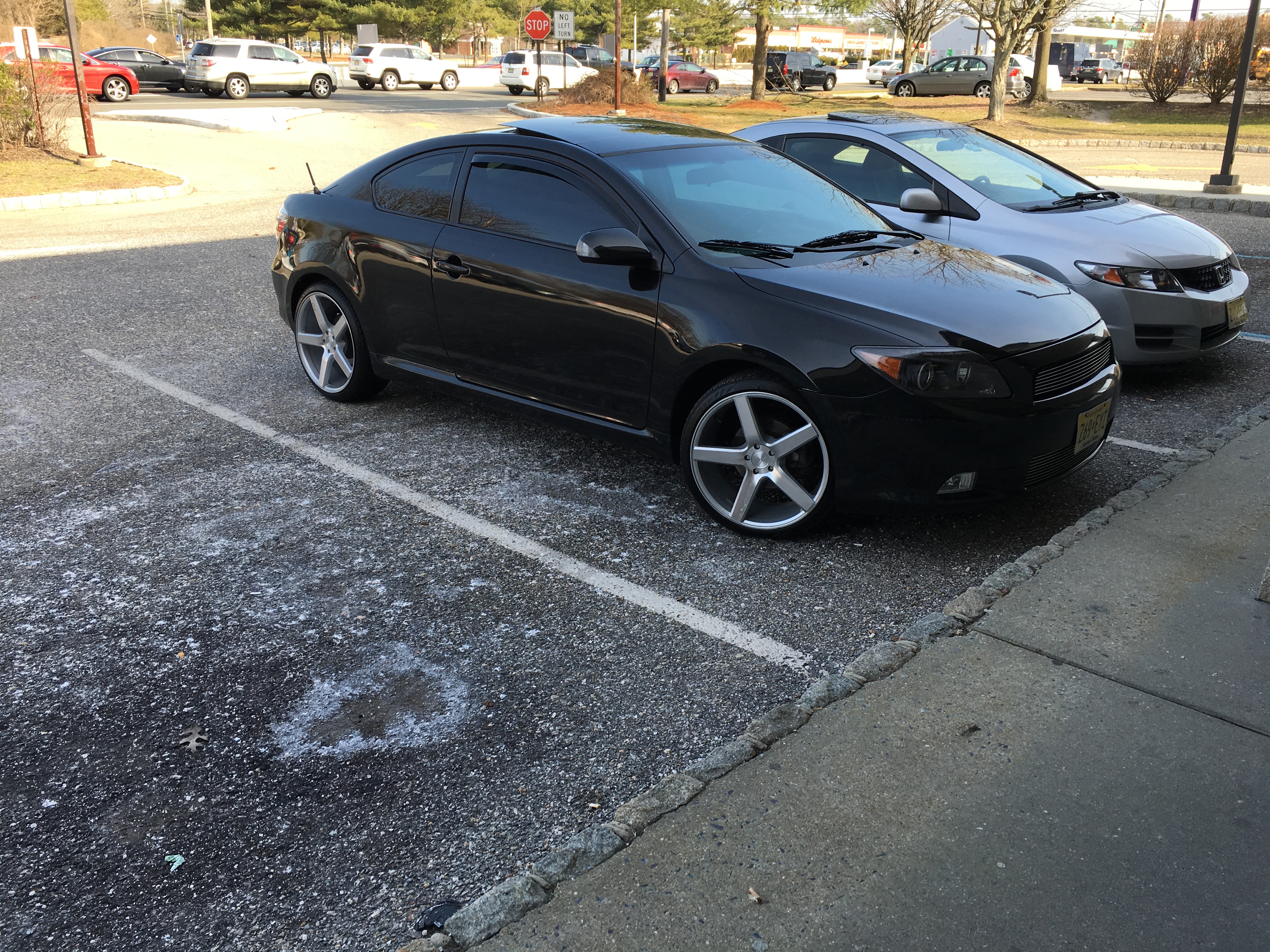

If I put a 4-1 or 4-2-1 header on would I need to change my exhaust as well to compensate for the air flow? Would I have any issues if I just changed the headers and nothing else?
Also anyone have any suggestions on better performances struts to go with my trd lowering springs? I don't want much of a drop especially considerating I'm already riding on 19s. Just want to try and maintain a comfortable ride as mch as possible along with good handling and looks

I agree with everything 07spectC already has said. but.. I just had to comment, did you realize that in your picture, behind your car in traffic was a black cherry pearl tc?!? I thought that was hilarious of a coincidence! You snapped a pic at the right time!!
