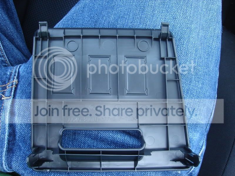

I got it off by pulling carefully yet firmly. Once I got one (bottom) corner off I could feel there is indeed a clip. But its more of a pressure clip - for your convience here is a photo of the back - this should help your planning. I believe you can reach under the dash and get to those clips - they are only on the bottom . The top is like a hinge. So yank from the bottom.

I thought this was the fuse panel under the dash:

Yeah, either one is pretty easy to get off, once you figure it out...

Yeah that second photo is the actual fuse panel. The panel I photoed gives you access to the relays and the accessory switch button panel right above it - if you are installing a switch.
