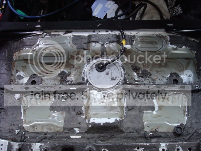

well im about 10 hours in now, the back 1/2 is prob only a couple more hours away from paint.

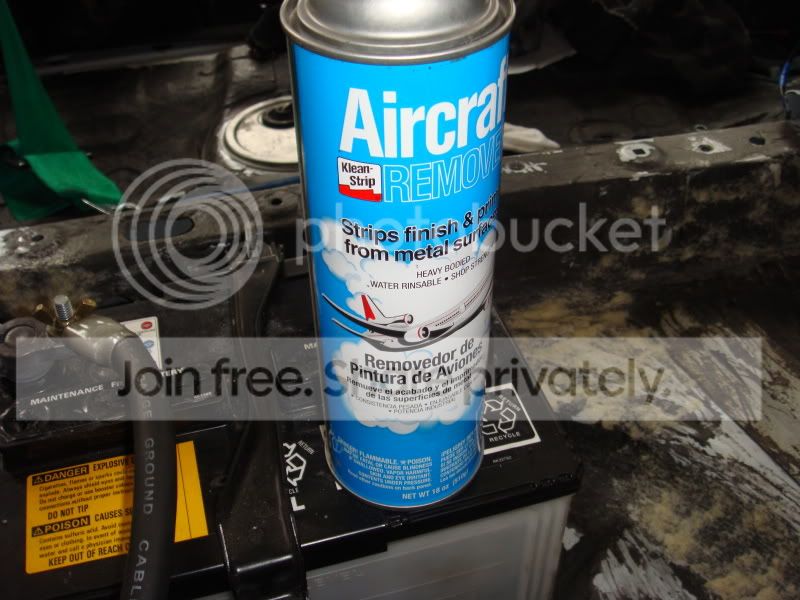

im removing all the liquid eDead that i put on the car because im taking it in a diff. direction.
only prob is when i used the aircraft removers it stripped off everything down to the bare metal so i realized i would have to re-paint or at least primer everything so that it doesnt rust. and i didnt want it to be all uneven.
also the aircraft remover seemed to make the eDead stick to the OEM sound deadening rather then remove it so i picked up some dry ice to take care of that.

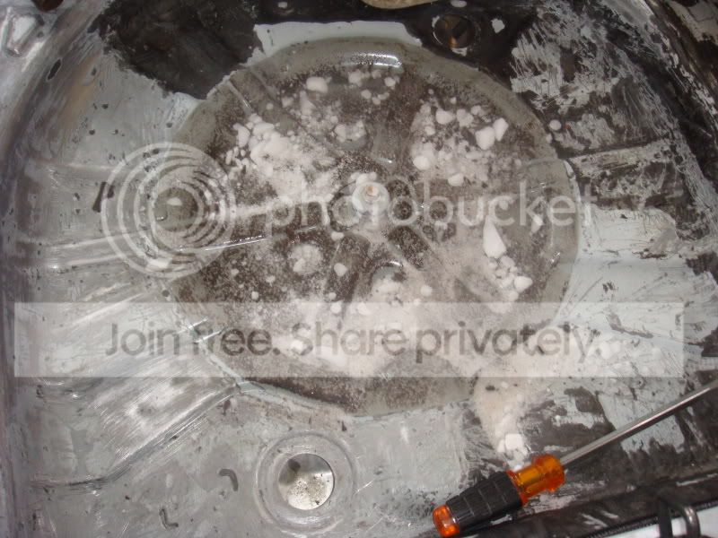

Wait, I dont get the dry ice. How exactly does that work?
Old Mar 26, 2009 | 04:58 AM
  #999
yellowxhoodie's Avatar
iTrader: (16)
Posts: 13,746
From: LOWLOW Chicago
its so cold that it freezes the deadening and let you chip it right off.
