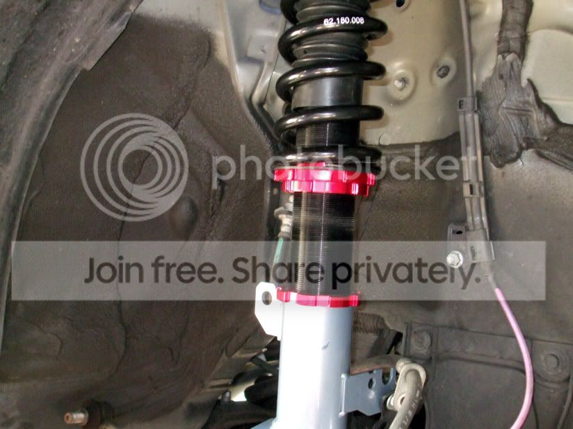

If you take a look at some pictures of coilovers, you'll notice some ring shaped collars that you can turn and rotate to move up and down over the shock body. It moves the position of the spring that holds up your car and adjusts the ride height of your car...
The red collars can be adjusted with a special wrench, usually supplied with your coilovers. It's a little bit of a pain in the butt, but you could slam it for the weekend, then raise it back up for the weekdays...
It's not as easy to immediately adjust your ride height as airbags... but the ride quality is MUCH better, and it's better than non-adjustable shocks and springs.
