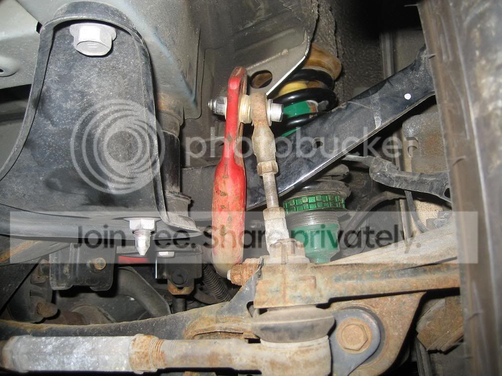

soooo it looked like that
and after taking it off you see the crack
Old May 17, 2008 | 06:01 AM
przemko's Avatar
Posts: 259
after closly looking at the endlink i must admit this
The whole force was pushing how the red arrows goes. The yellow shows where it broke ( the other side ).
The whole stres was on the body of the joint rod and not on the ball. The problem seems to be with the swaybar ( hotchkis ) cause i couldn't set up the endlinks to face the swaybar straight forward...... i checked the second one ( endlink ) and it was bended in the same place so it would broke soon.
The question is ..If this should hold almost 5000 pounds of load and it broke maybe it's not enought. I ordered new joint rods and those hold up to 9544 pounds

Wow, there is deffinetly something installed correctly there.
And the rust going on under your car is insane. The sway bar and everything else is just waiting to have issues.

Looks like a poor install.

Is it supposed to be angled like that?
Old May 17, 2008 | 04:24 PM
Rydrdg's Avatar
Posts: 955
From: Area 51
Yah, I thought bolt and link suppose to go on straight

that's the problem with the hotchkis sway.
I tried so many lengths of endlink so it lined in with sway but thats the best angle ( smallest one ) i could get.
check the link it's from dezod website.
http://www.dezod.com/pd_dezod_motors...ompetition.cfm
The face where you mount the endlink at the hotchkis sway is at a different angle them the progress one.

On my first set, I intalled them incorrectly, they were angled like that, then they broke. Then, on my second set I used washers as spacers to make the assembly more vertical. I adjusted the height so that the bolts going through the sway were vertical. So far no problems...*knock on wood*
