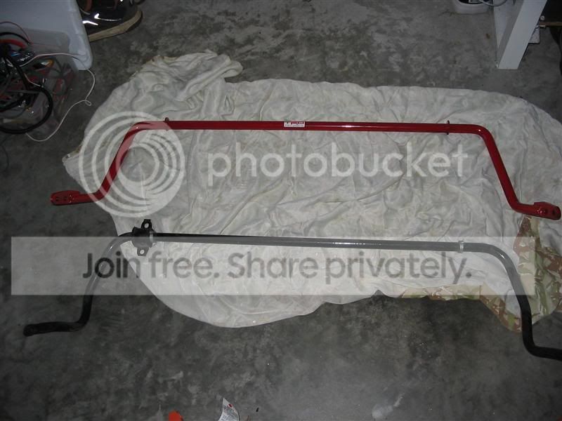

Here is a pic I took of the TRD bar next to the stock bar (automatic) when I was installing the TRD. You can see that the TRD is not only thicker but a different shape than stock (no curves).

hes right, a sway bar is just a torsion bar. its a big spring that twists. The arms work like levers a longer one makes it easier for the car to twist the bar, effectively making it like a softer bar. Thats how the holes at the end make it stiffer or softer.

less curve - less bending..
