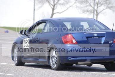

Last year on trd sprnigs and rear sway. :D Not the biggest lift but nearly two wheels so I like that pic.
The stiffer springs (SS-Ps) that I am on now should prevent more of it since the front cant roll over as much.. but its hard to tell at this point.
