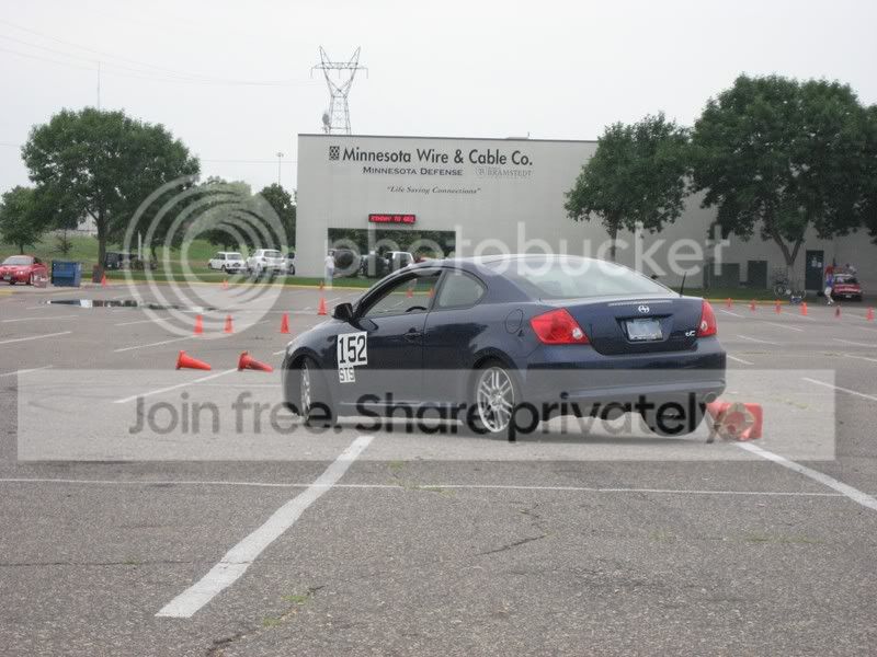

Originally Posted by CarbonXe
I've done it twice so far, without even trying. Once was right in front of my friend, I took a turn pretty hard and the back end kicked out, then my friend told me the back wheel came up about 2-3". Then I did it again today a little. I need to stop beating my tires up . They're gonna hate me in a month after the turbo goes on .
Also, do you know what the spring rate is on the front springs? I'm trying to figure out of the front end is going to drop at all after the turbo, piping, IC, etc..go in there. I want it to drop like .2" more, but doubt that stuff is enough weight.
Here is about the most comprehensive data I know of for tC springs.
http://www.yoursciontc.com/forums/in...howtopic=16894
And.... of course..... 3 wheelin !

3 wheelin... +1 sec, though :D
Old Jun 20, 2008 | 10:48 PM
  #46
engifineer's Avatar
Posts: 9,731
From: Minneapolis, MN
Yeah.. I killed that stupid cone all day long too (Actually.. two seconds per cone). At least I was hitting it with the back wheel, so I was at least doing it "right" . The funny thing is that it looks like my car is hiking up and side kicking it as I go by.. which I am convinced is what was happening
