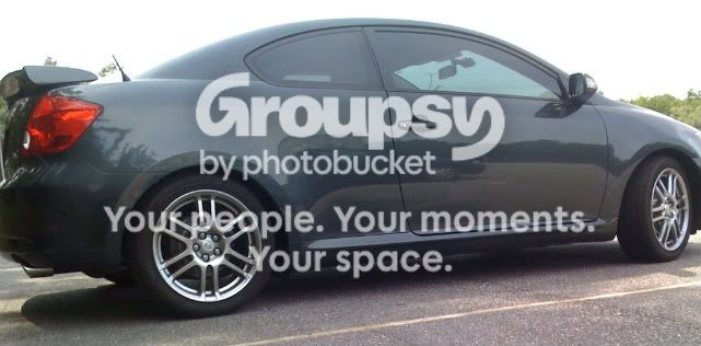

Here's a pic from yesterday. Two days after dropped:

^^^^looks nice

looks good !!!
