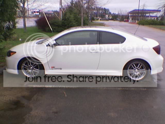

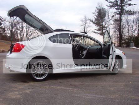

Old May 10, 2006 | 09:26 PM
russian_tC's Avatar
Posts: 65
here you go tkey....factory 05 tC ride height
front
rear
thats what it looked right after Hotchkis springs were installed(sorry for bad quality - cell phone)
