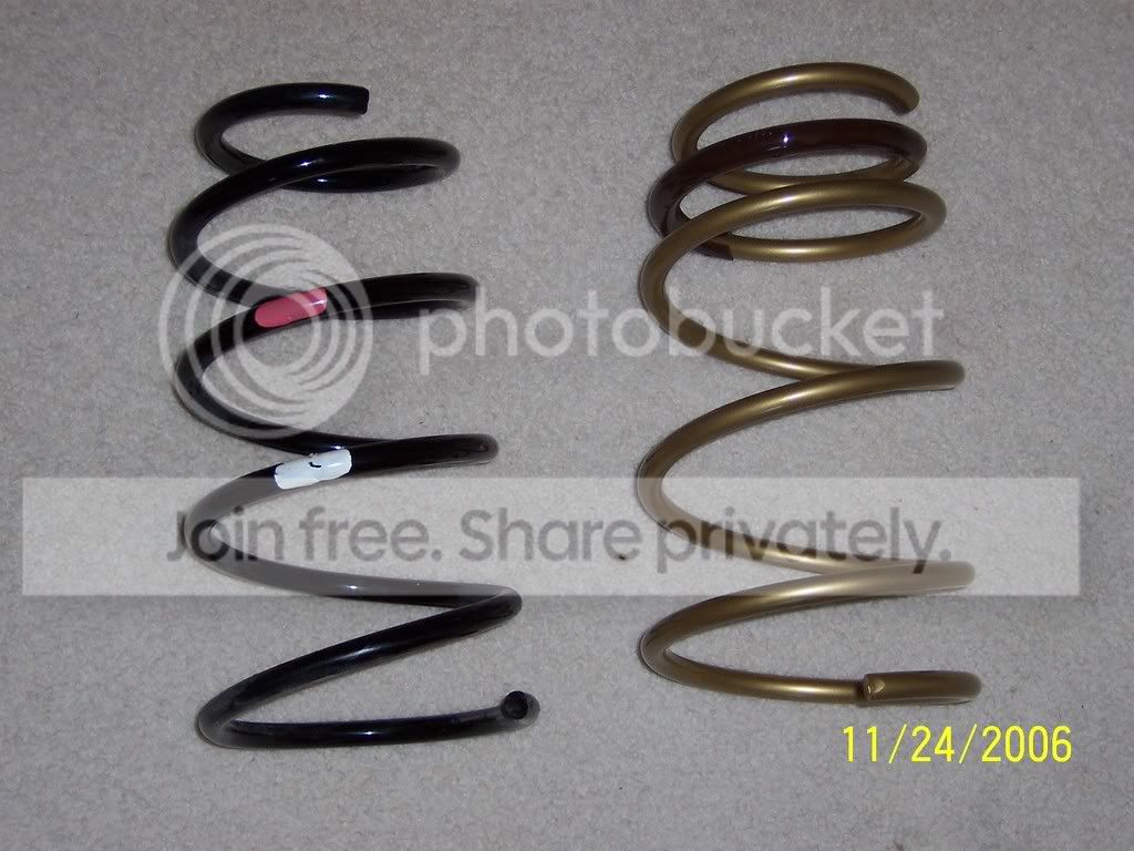

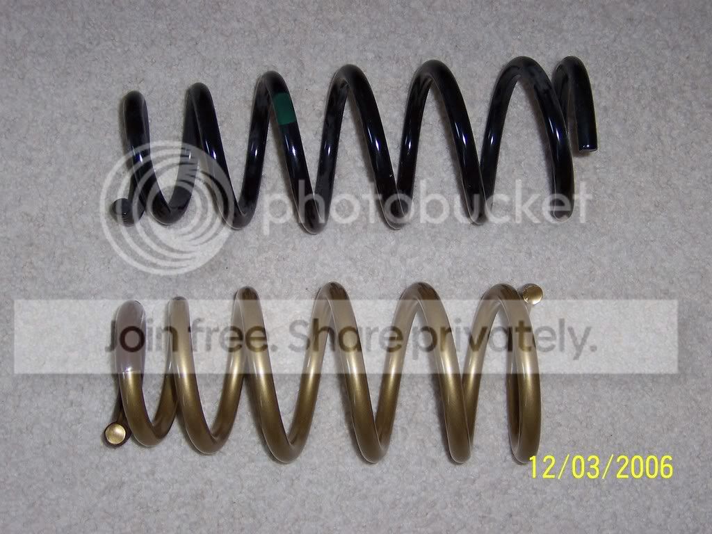

Don't know about your Tein coilovers, but Tein puts hard rubber insulators on their springs.
Fronts:
Rears:
The "spring noise stoppers" linked in the earlier post sounds like a good idea. These photos show you don't need very many, just on the coils in very close proximity. My H-techs don't sqeak at all.
Notice on the fronts they didn't have to insulate each of the 3 closely-spaced coils at the top, just half of the coil in the middle.
Yeah, thats b/c of the three coils the top one and bottom one are going to touch the second(middle) one in the same area where they put the noise stopper. Pretty much a cheap solution for them that works! I've had zero squeaks with mine and mine are h-techs too.
