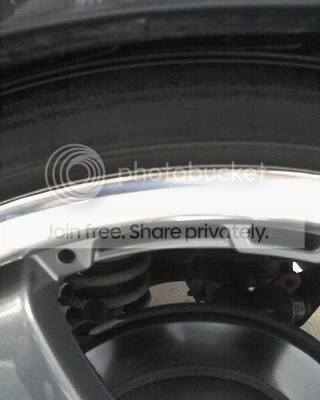

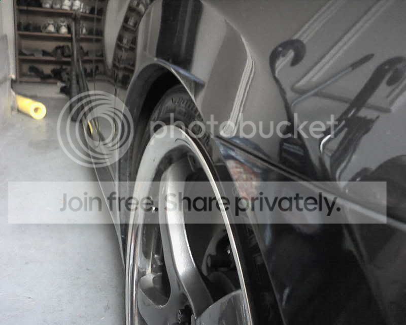

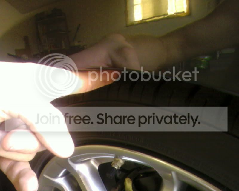

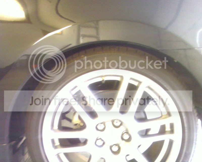

Just thought that I would post some pics
Rear right to show spacing
Show under fender what appears to be rubbin
Show tire and where it is rubbin
Pic of offset and space

I don't see how u should be rubbing at all. Like i said one of the guys in my car club has the same size wheels and tires and has a lot lower drop and he doesn't rub like that.

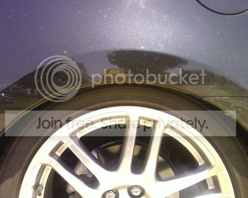

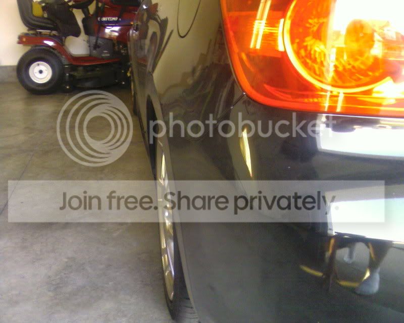

even though your wheels stick out more than the stockies, I still don't see how you are rubbing like you are... here is mine...
even with two people in the backseat I still don't have ANY rubbing issues...
are you sure it is not your struts? I noticed that my rear camber seems to be more than yours, ever got an alignment after you got the springs? I aligned mine and I know both rears are at -1.0 degree (middle of spec is -.9 I believe) so I know my setup is good... hmm still believe it is probably the shocks... interesting to see the culprit... oh and sorry bad quality pictures I know but my digi is out of batteries so I had to use the phone...

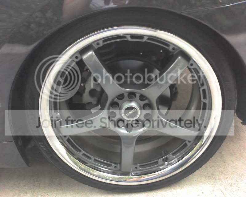

The rear driver side rubs most often. sorry, camera phone pics but theres no gap.
Left side:

Looks like you have the wrong offset on your wheels.
Old Jul 17, 2007 | 02:36 AM
jdmtc2008's Avatar
Posts: 265
its your offset i had to change from the hp wheels to motegi wheels and 18x8 is pretty wide for a c
