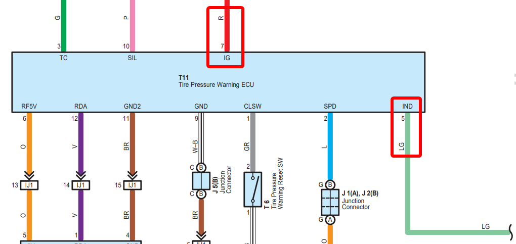

During normal operation, the TPMS computer sends 12V to the gauge cluster. If there is a fault in the system, it won't send anything to the gauge cluster, and the cluster will illuminate the TPMS light. This is why simply disconnecting the TPMS computer still keeps the light on.
The solution is to always send 12V to the gauge cluster while the car is on, so the light won't illuminate. Luckily, the TPMS computer already recieves 12V on ignition, so we can just steal that from the connector. I found this solution on a Prius forum, looked through the wiring diagrams for both and found that they work identically. I wouldn't be surprised if this works on a tC2 or any other Toyota products of the era as well. I'm not responsible for messed up TPMS computers, gauge clusters or wiring though :)

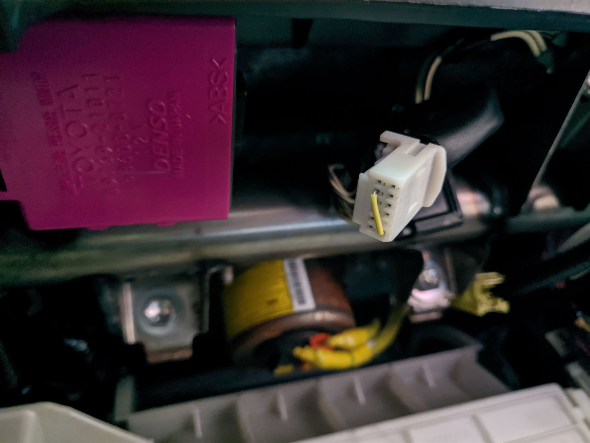

^ Shown above is the TPMS computer, and the wires that need to be connected together.
The TPMS computer is located behind the glovebox and has one connector (T11).
^ Connector T11. Pins 5 (light green wire, to gauge cluster) and 7 (red wire, 12V ignition) need to be connected together with a jumper wire.
^ My solution: a jumper wire between pins 5 and 7 of the TPMS computer's connector
I disconnected the TPMS computer, installed the small jumper wire, and the light is gone. If you want working TPMS again, simply remove the jumper wire and plug in the TPMS computer again.

The connector is directly above glovebox, so you'll need to take the glovebox out which is also pretty easy to do. Once the glovebox is out, look up and you'll see the pink TPMS module along with the T11 connector.
