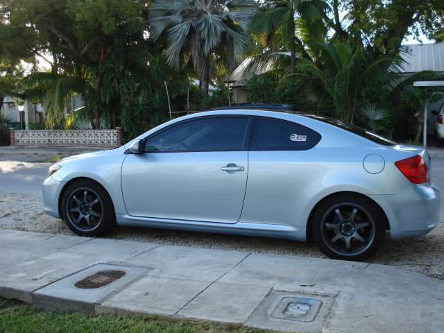

You will be fine! I got 225 on a 17x8 with H&R sport springs which dropped more than advertised (which i like)! I dont rub! I have on a serious storm drain dip as i turned but thats it!
Old May 16, 2011 | 12:46 AM
Eleanor_tC05's Avatar
Joined: Jun 2010
Posts: 285
From: Florida
Would you mind taking a picture for me please?
I got some in my photobucket! Hold up a sec BRB!
Old May 16, 2011 | 12:53 AM
highvoltage1's Avatar
iTrader: (11)
Posts: 6,550
From: Tampa area
This help?
This help?
yeh sorta, I appreciate it. I pulled my wheels off and I saw that the offset was 42 so the difference is only 7mm. I'll be fine. I just got confused. Thanks for all the help everyone. Sorry dropzone, I didn't realize that your message was for RS1
