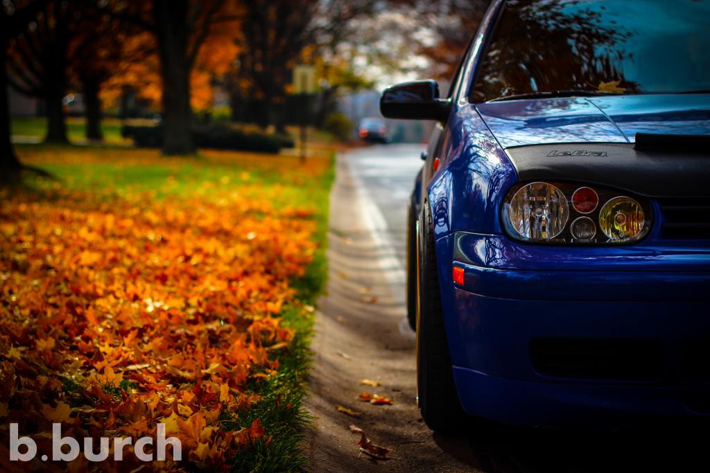

i recommend 225/40 for a 9.5 inch wheel. You can go narrower like 215/40, but why spend extra money on harder-to-find sizes. get the smaller size if you're going to be slammed/tucking tire. 225/40 is made by every company, so they cost less. i have 215/40, which cost about $15 more per tire than a 225/40. I recommend Achilles ATRs because they stretch well and they're inexpensive (I have these).
Here's a 225/40 Falken 452 on a 18x9.5 Rota Grid.

Thank you very very much HKS, just ordered my grids. Then tonight ordering the tires, will post pictures when I have them installed.
