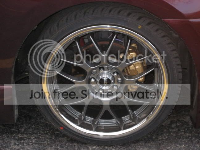

I have 18x7.5 all around and they fit good on the TC. I have then in anthrosite. I believe I'm using 225 /40s with them.

can you post up some close up pix of how the lip looks...

Best I can do for now.

. . . .ok.. im getting these in black for sure now.
thank you so much for the pix and your help!
