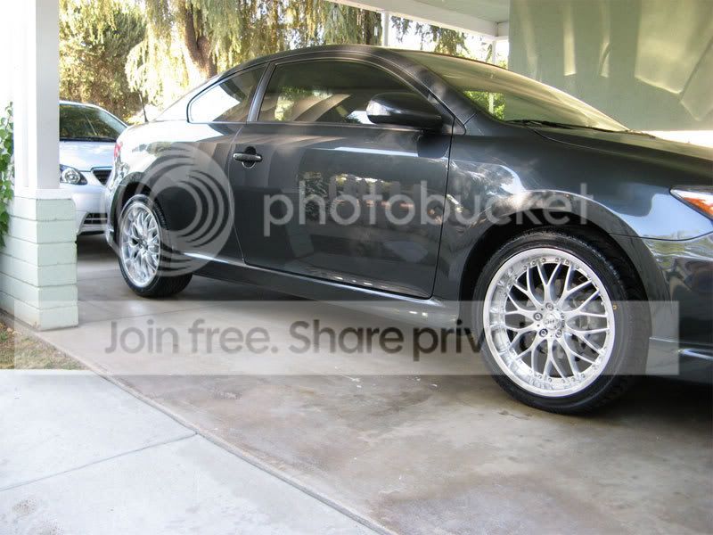

Here is what i was getting all worked out =op

drop that ish, such nice wheels, but the gap is so huge
anyhow, wow super shiney, for a moment I thought the reflections were decals.
nice!

^^^ HaHa....I was gonna those are some FUGLY look'in Decals!!!...hahahaha.......
Those are TIGHT wheels!....How many lbs each???
Old Jul 5, 2007 | 03:47 PM
scoobyroo2002's Avatar
Posts: 1,251
From: SoCaL
LMAO! Decals....you so silly. Honestly i am not sure how much they weigh....i think i read it somewhere but i forgot.
YES!!! i need to lower it badly! it will do for now....i am working on saving teh funds for it. So...ITS IN THE WORKS!!
