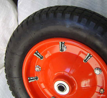

- D - get a wheelbarrow wheel and put all four sensors on it. then inflate the wheelbarrow tire to the correct pressure and ride with it in your trunk, or back seat.
Excellent!

Old 05-22-2007, 01:11 PM
-afinite-Konig-'s Avatar
Join Date: Apr 2007
Posts: 12
LMFAO
-afinite-Konig- is offline
Old 05-22-2007, 07:50 PM
Admin Emeritus
Tomas's Avatar
Join Date: Jan 2005
Location: University Place, WA
Posts: 14,570
Couldn't resist. :D
Tom
Tomas is offline
Old 05-22-2007, 08:06 PM
Join Date: Apr 2007
Posts: 12
Oh that's hot! Where can I score one of those?!
