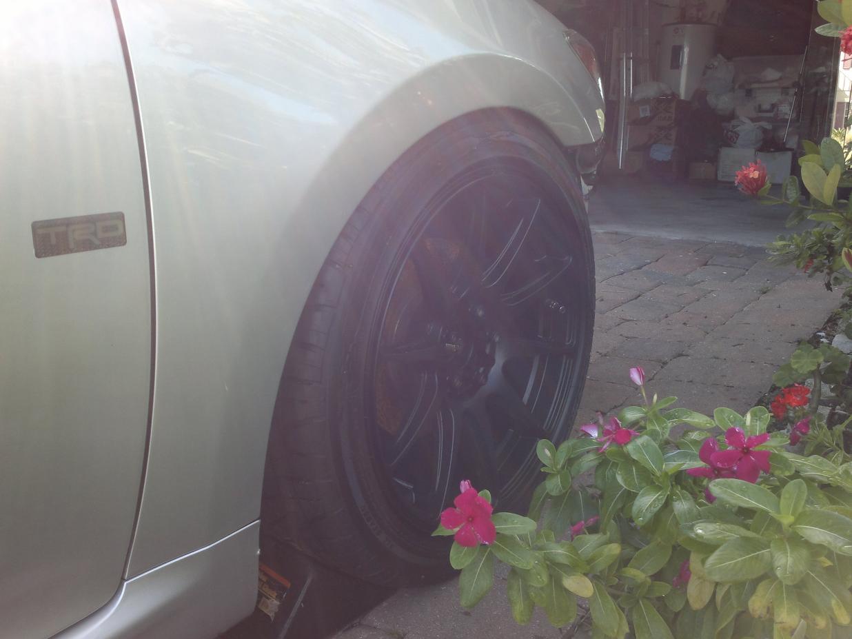

Here is example of how 17x8.25+35 on a 225/45 R17 looks with race-land coils. Just perfectly flush but for me I get slight rubbing on bumps and my down-pipe takes a beating.
To correct itscurtsk you will not tuck tires unless your slammed and even then it will be difficult to tuck because these wheels are 8.25+35 or if you go +25 you definitely won't tuck. If you get B&G's and want to go low you'll need some fender work because you'll eat up your tire sidewall from too much contact with the fender and wheel well.
Excellent. That picture helps. Thank you. So tire-wise, a 225/45/17 would be just fine and won't have any drastic stretching going on. But with these xxr's i can't keep it in the fenders? Is that because of the 8.25? So if I were to change up rims and get a 17x7.5 at the most, then I could probably stay tucked? without messing with camber?
