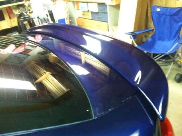

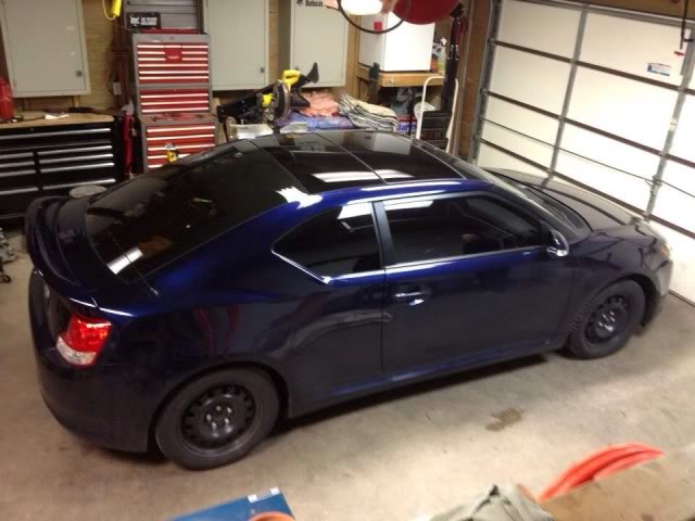

Heres pics for those interested:
yes, it is dirty i know, with a combination of snow, rain, salt, sand on the roads the car gets dirty very quickly here in the winter time

Paint match was basically spot on, quality of the paint job was pretty good on mine too
Its the same as the factory wing, only difference is how it actually fastens to the trunk with screws, from factory their held on by tabs and screws
I recommend this to anyone really as long as they are comfortable drilling at least 4 holes in their trunk without messing it up lol
Over IMO 9/10, only cause directions are vague, really gotta read through them to understand what it's talking about when prepping the spoiler to match to the trunk to drill the proper holes
