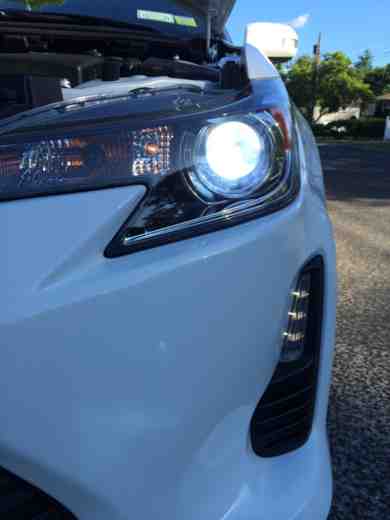

Yesterday I installed an HID kit in my tC but I would love to get them aligned correctly. I need to know where the aligning screw is on both headlights how exactly it should look. The stock cutoff isn't blinding anyone but it's a bit blurry at the notches and not perfect cutoff blurry. Please send me pictures of where to find the alignment screw on my tC and how your cutoff looks. Thank you have a great day and drive safe fellas.
2014 Scion tC HID Alignment HELP!-imageuploadedbytapatalk1402117808.106239.jpg

The funny looking round wheel with the 10mm in the middle. You turn it 2 or three rotations and you'll start to notice up or down.

Flat ground aimed at garage or light colored wall. 3-4 feet distance.

Ratchet is easier but any 10mm will turn it
